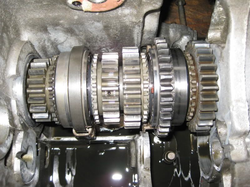

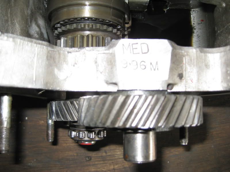

To work out the ratios, divide the big number for each gear by the little number. Then use guesswork's site to work out what set you probably have.
19th Jun, 2011 at 06:09:08pm
How many teeth on your primary gear?

I gave MED a shout and all they could tell me was that it is a "S/C C/R WITH QUAIFE ATB AND S/C CWP".

That isn't a Quaife ATB - well it's absolutely nothing like my one anyway.....

Drop gears will be 1:1 then.

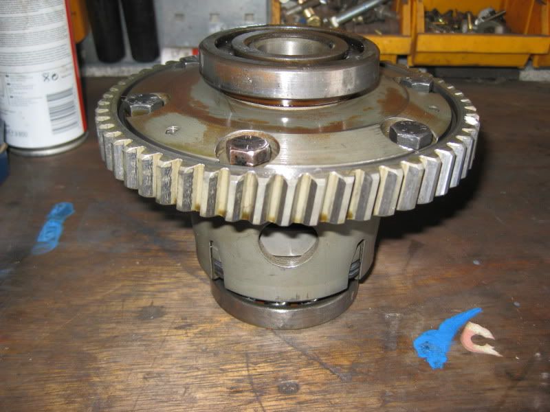

You may want to consider changing the FD ratio to something more suitable for a turbo engine. A 3.2 or 3.1 would be much better for road use. Saul Bellow - "A great deal of intelligence can be invested in ignorance when the need for illusion is deep."

You cannot just change the pinion. The crown wheel and pinion come as a matched pair. Edited by Paul S on 19th Jun, 2011. Saul Bellow - "A great deal of intelligence can be invested in ignorance when the need for illusion is deep."

why not just change the diff??? and keep the box. one day boost will be mine!

What, change it for another LSD at £500 or for a cheaper X-Pin?

yeah change to a cross pin and pick up a 2nd hand c+p that'll keep the cost down thats what i thought you meant when you said about rebuilding the other box at a cost of £600. or yeah fork out for another lsd with the available c+p. one day boost will be mine!

For the road, use the Minispares cross pin diff. You should be able to pick up a crown wheel and pinion for around £40. The only thing you'll need then is the diff output shafts, maybe diff output side covers depending on which ones are fitted for the LSD.

You can get any crown wheel you like and have it machined to go onto an LSD, think the price I was given was about £100. |

The £600.00 was for a SC gear set from MiniSpares at a cost of £353.07, a MiniSpares Molybdenum Cross Pin Diff at a cost of £136.16 and a crownwheel and pinion 3.1 ratio at a cost of £120.00:

Just change the diff, the crownwheel and pinion. The diff output shafts, you should be able to pick up real easy as will be the diff side covers if you actually need them. THAT is going to be the cheapest option.

So are the diff output shafts and side covers almost unique to the diff i.e. some diffs have to have special covers and shafts?

Those are standard pot joint diff side covers and will be ok. The output shafts for the LSD are specific items for the LSD. You will need standard type pot joint diff output shafts a cross pin diff and a standard crownwheel and pinion of the ratio you want. I woud suggest that for the roard around Jersey the 3.4:1 ratio will be plenty good enough, since the 40mph limit is a bit of a show stopper. On 26th Oct, 2004 TurboDave16v said:
