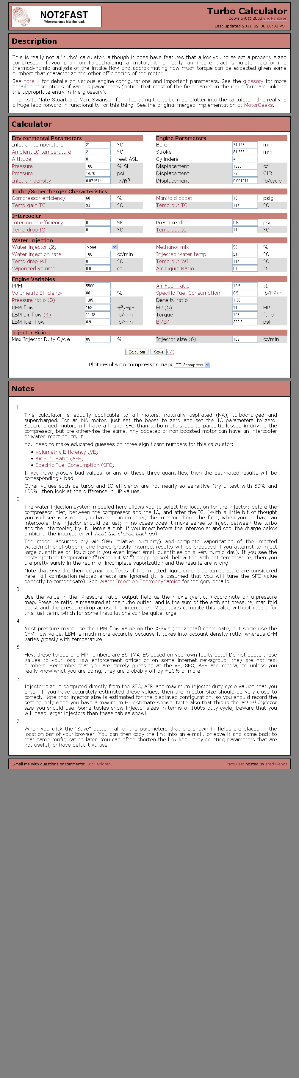

Peak torque rpm of the 274 cam will is published by Kent. Use this with one of those turbo calculator thingamybobs with the boost set at 12psi, then calculate the air flow with 100%VE and 75%VE giving you an idea how much air the engine will consume.
Once you have an air flow figure for the engine, you can then try and work out what speed to run the charger at at peak engine torque RPM.

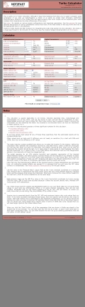

http://www.superchargerperformance.com/sup...r-modifications
Estimate of peak power at 5500rpm
Air consumption of 231 m3/h at PR of 1.8, 75%VE at 5500rpm. Peak power gives 98hp and torque of 94lbft
Air consumption of 309 m3/h at PR of 1.8, 100%VE at 5500rpm. Peak power gives 131hp and torque of 125lbft
Or peak power at 6000rpm
Air consumption of 253 m3/h at PR of 1.8, 75%VE at 6000rpm. Peak power gives 107hp and torque of 94lbft.
Air consumption of 338 m3/h at PR of 1.8, 100%VE at 6000rpm. Peak power gives 143hp and torque of 125lbft
all the above calculated with an AFR of 12.5:1 and SFC of 0.5. Bear in mind that these are estimates to give you an idea what you may or may not end up with. I have used the peak power rpm for the 274 cam from my dyno charts with the 1400 and same cam with 1.5 rockers. Power peaks around 5500rpm and then is pretty flat up to 6000rpm before it starts to tail off.
So realisticaly you shold expect to be somewhere between 98hp worst case, and 143hp in an ideal world*happy* with an airflow somewhere between 231 and 338 m3/h at 5500 to 6000 engine rpm.

The calculator I used takes into consideration the charge temps, and the intercooler efficiency was set to zero with a compressor efficiency of 75%
To be honest, I dont think those figures look far out, especially if you take the first two results and average them
