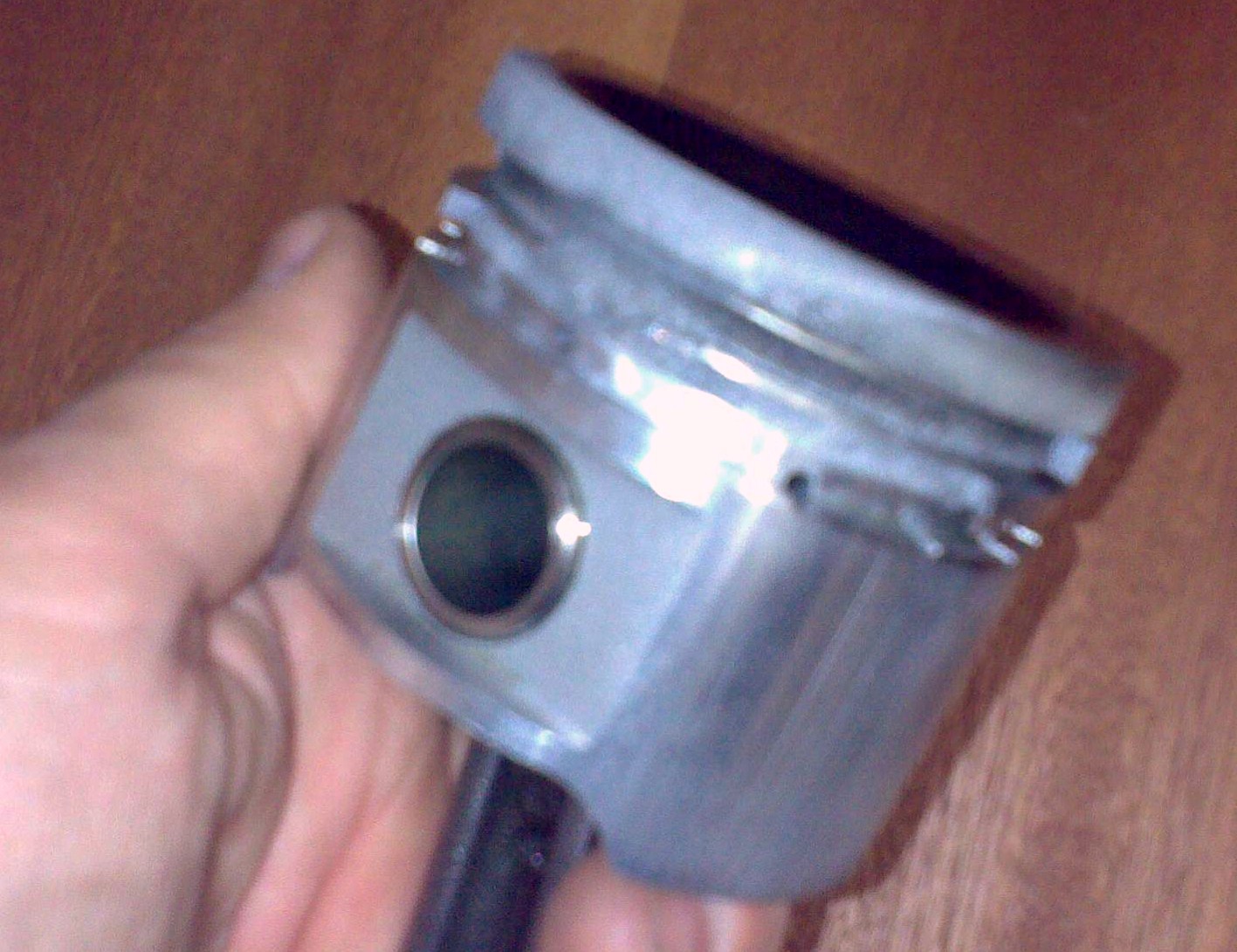

well today me and a friend started taking apart the minis engine as it was smoking and driving really badly. we had already found some creamy gunk in the rokkor cover so were not expecting good news
the gasket seems to be fine.. but the number 2 piston has got a big dent in it... now my question is, any ideas on what caused this? i did notice the dizzy was running without the vac pipe connected.

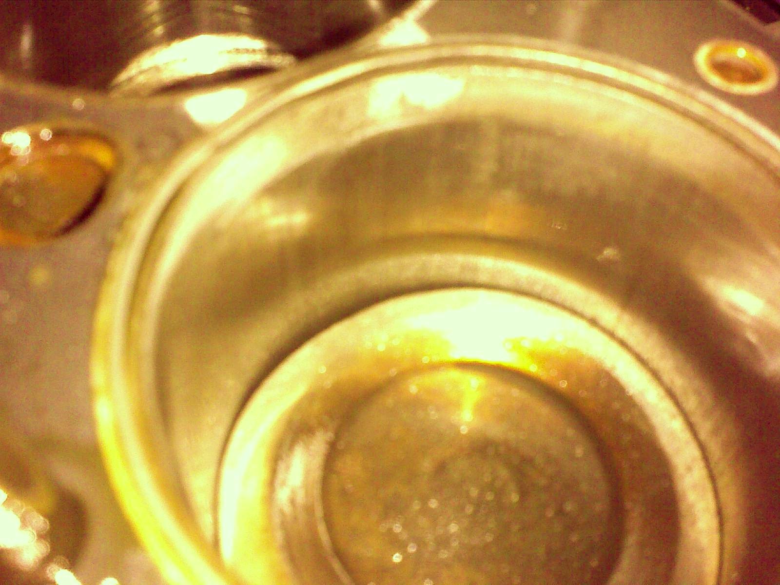

also these rokkors look strange to me, are they not supposed to my alined with the valve, on some of them just the edge touches the valve.. is this normal?
this pic shows what i mean better

6966 Posts
that piston is done for , a rebuild is on the cards,
and thoase rockers look about right for the standard limit of missalignment
carl
4642 Posts
That piston damage is caused by detonation.

hi guys...
carl, i thought the rockers had to be dead center on the valves...
phil as for detonation, could it be for the fact that vac pipe on the dizzy was disconnected? the fuel pressure regulator was also set to 1 or 2 psi less than what its ment to be...

Ben H
3329 Posts
Member #: 184
Melton Mowbray, Pie Country
I doubt that it was to do with the vac pipe. This is only used at cruise or tick over. Once on boost it would make no difference. If you are running a dizzy though what is the max timing set at. If it advances to >25 you could be causing problems.
If the fuel pressure was low you could have been leaning out, again could cause the problem.

as for the rockers, they are like that from the factory....lol

ben H, i have no idea how to check the timing degrees mate.. just recently started messing with the mini. all i know i learnt on here and watching the bill solis dvd. some help maybe?
benross, the rocker question just shows how little i know..lol the engine was running stock boost so 7 or 8 psi if im not mistaken. no bleed valve, no ecu and standard actuator.
i looked at the cilinders, and no cris cross marks on them, so i suspect your right about the milage but dont know as it was bought off ebay.
Time fore a rebore and new pistons....

standard boost is 4psi with the metro's ecu removed, my guess is that timing was too far advanced and it has done a lot of miles.

the gasket has gone between 2&3 from what i can see aswell.
Denis O'Brien.
Looks exactly the same as my hypatec piston after avon last year. I bet its blown through all the rings!

Yep.
Snap ! Detonation.
Here's a pic of my No 4 piston in April last year.
You'll find yours is burnt down into the ring lands when you get the piston out. Hopefully the bore isnt goosed, mine was ok. But if yours is a high miler then I'd go to the next piston size up with a rebore as well if I were you. It's not difficult so don't get too put off just yet mate. Chin up, those new pistons are just waiting for you !
