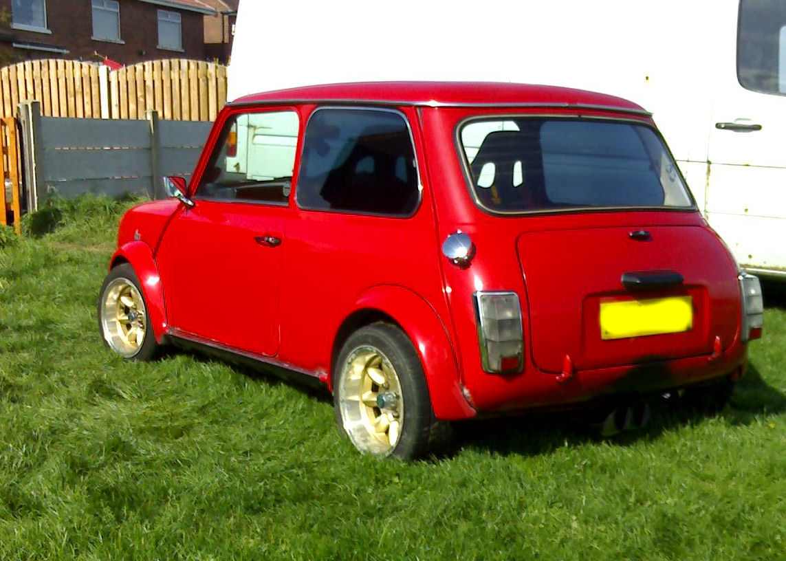

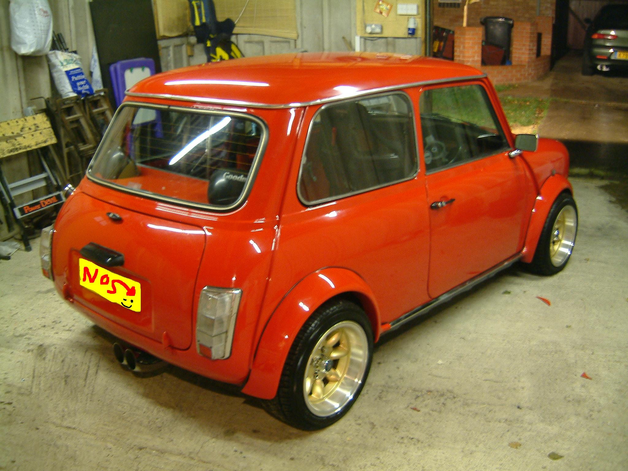

On 29th Jun, 2011 fasteddie84 said:
I did a bit of searching yesterday and found some photos but I plan to deseam the rear end and there aren’t many photos of the setup I want with a smooth butt. The only photo I found didn’t look right, not sure it the height was too high or the arches different. I plan on running 13x7 deep dish with MiniSport group 5 arches and lowered.
this was mine mid 2004
its a 3" twin up swept, i had to shorten the link pipe by almost 4 inches to get it to tuck up and follow the lines of the rear valance, that was the part most people spoke about the way the lines just flow almost as though it was the standard look, over time the heat burnt the paint really bad but the carbon build up covered it up so i left it, must have been nearly 5 years it was like that
the photo infront of the transit is when it was at its best looking but also just after that it failed its mot and came off the road for its first turbo engine and a new front end its never looked that good since *frown*
edit: also in the pic in the garage it had 2000watt of audio and a carpet *happy* it slowed me down so it went in the supra*happy*
