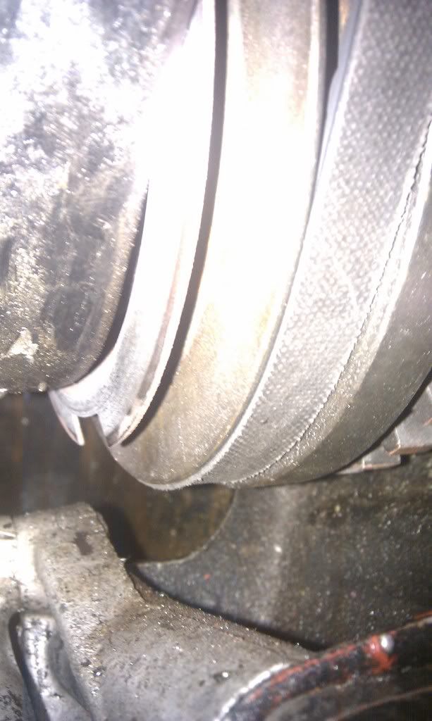

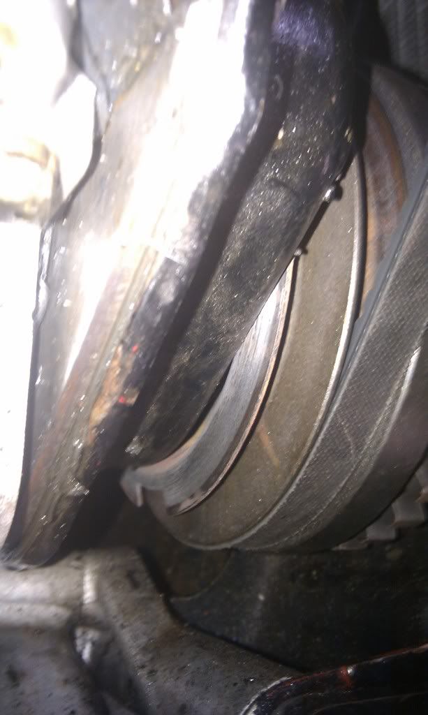

had a quick look under the car, this is what ive found.....
now does this meen i have to take it all apart or can i get away with bending it a little, cant remember how it go's together.. :/

It looks like you might be able to bend it a bit as it only seems to touch on the outer edge. You'll need to make sure the pulley bolt is still tight too, as if you tightened it while the pulley was touching the cover it might not be correctly torqued.

this is what im worried about, it came losse before. so when i changed the pulley i torqued it up to about 180lbs+ ish with loads of locktight, i hate the setup ive got, its shit! when ive got the money ill get a fenton on there.

On the same topic. What purpose does that piece of steel that in your case is catching serve? Mine caught badly on my build so i completely removed it. I was running a belt drive set up but have reverted back to a duplex and original cover and now have loads of room.
To do it properly the pulley needs to come off, drill three peened over rivets out, then that useless tin cover will come off to be stamped upon and thrown in the bin.

how good are ya with a hammer and sharp chisel???? thats what i did with mine

thanks Tom, when it comes off im going to be doing that all right and then give it to gary to grind till his harts content!

i'll try giving it some wackage before!
easy fix sorted!
