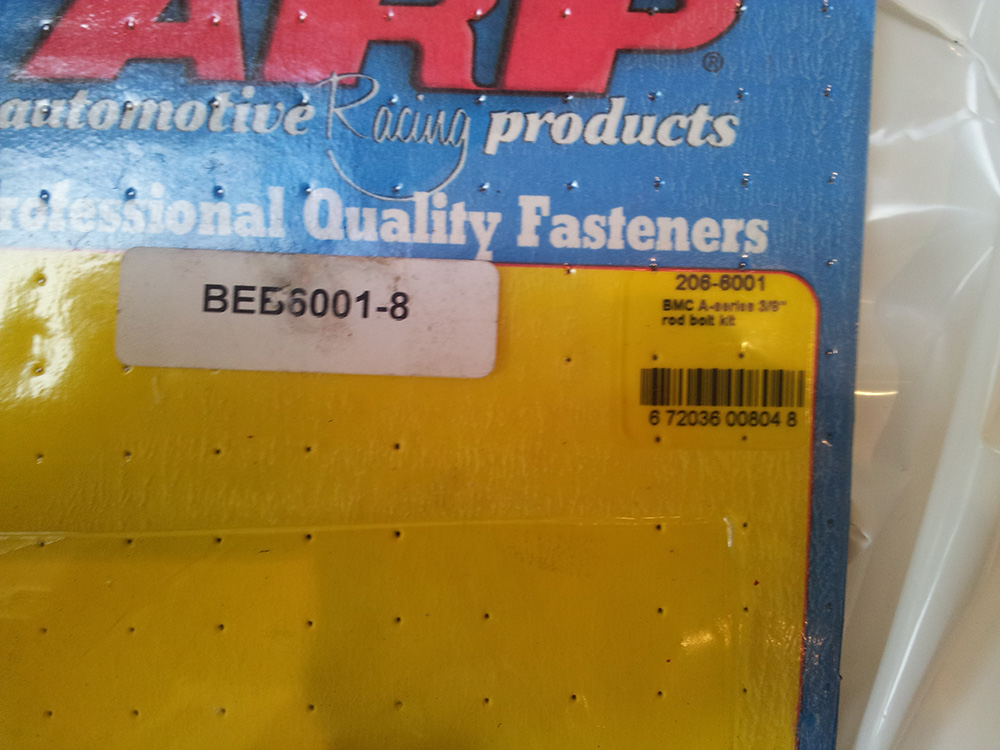

whats the part no on the ARP packet?

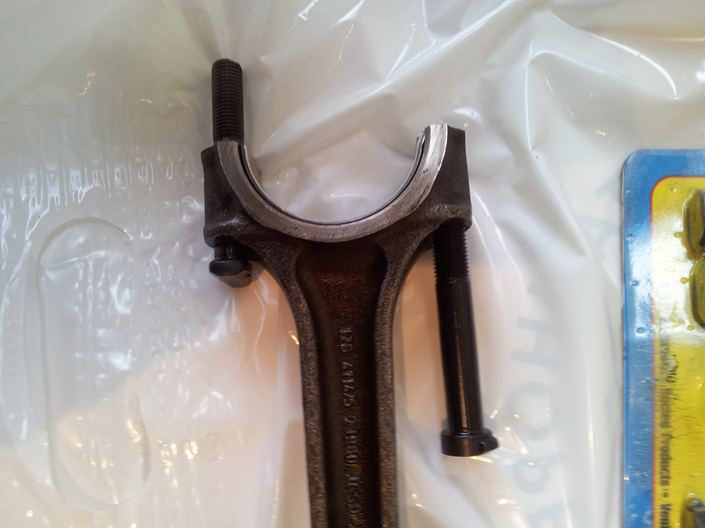

These are the pics ive got.
apparently theres 3 types of arp bolts...
Rods are out of an A+ engine.
Any help is appreciated
they are for cooper S rods,
you want the 206-6002's
