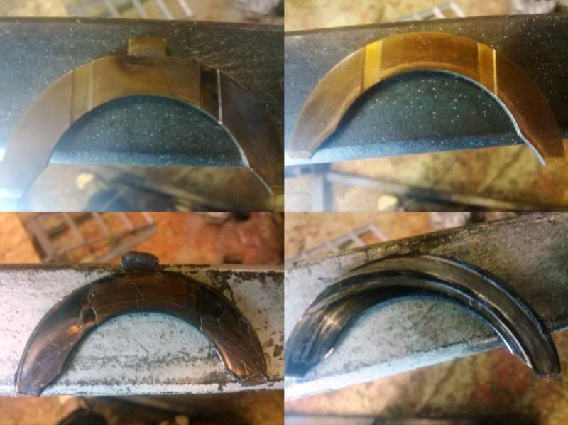

Unlike the 1275's when you machine the small bore main cap you remove the locating feature for the thrust washers its been covered a few times on here, what you need to do is have the locating grove machined into the centre main cap.
you can just about make out the slot in these pics.

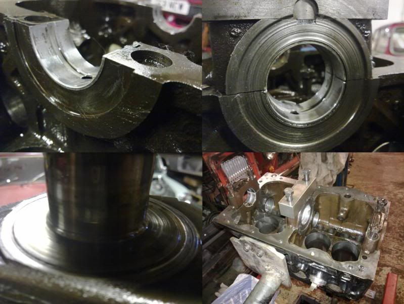

This damage resulted from my machinist putting a slot in my cap that was wider than the standard feature on the cap. which allowed the thrusts to move like you you describe just not as much.
in the top right photo you can just about make out the remains of the old slot in the bearing cap, its also noticable how much bigger the slot is in the strap, just make sure the slot is the right width as its an expensive lesson to learn, as this cost me a new machined crank and block!
i'll post a pic later of how my new cap has been machined up.
