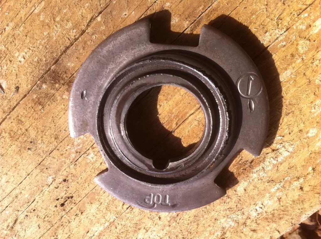

Pop quiz what is this item?
I think the throw barring may be the wrong type? Or maby I'm just a dumb ass and had it to tight? Or maby the heavy
diagram? I think a bit of all 3 contributed
Since swapping that destroyed peace out with one from another stock diagram I now have perfect clutch agane but I feel a pulse in the first part of the peddle I'm gussing that's a bad thing...
^ what causes this?
Something isn't right there, the wear is off centre on the plate, so the bearing can't be running true to the flywheel.
Check for wear in the plunger hole in the wok.
EDIT: Found a picture of one I broke earlier. Our groove is more central to the plate.
Edited by apbellamy on 18th Sep, 2011.
We have done one off centre before too.
I think what causes this is a shagged bearing that is loose on the plunger,
there is a clip that holds the bearing on and I think the idea is that the clip should hold the bearing tightish so on the first use the bearing self centralizes and is then held in that place forever after, if the clip is shagged the bearing will drop each time, and contact on the piss, if the bearing is also notchy enough to stall it will quickly wear a groove that will just get deeper and deeper.
thats my theory anyway.
