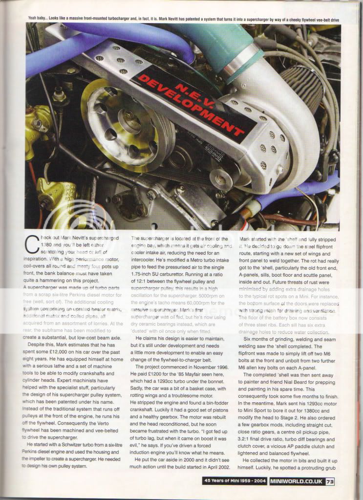

It's been done see MiniWorld Nov 2004

i recall a mini years ago with the guts of a truck turbo driven by a belt around the flywheel and around a wheel where the turbine used to be.. anyone else remember this? was some discussion on here at the time.

Looking at the belt drive in that article, I'd have to say there isnt a hope in hell it would ever work. Load of balls.
The belt would slip like fuck, and if it was a toothed belt, there might be 2 teeth engaged on the blower, which might last 10 seconds.
In fact, I'm nearly going to call balls, because I cant see any possible way that the larger pulley could even turn. It almost looks like it's bolted there just for show.
Centrifugal blowers are actually very good, but they arent so common simply because they are bloody expensive.
In many ways one on a Mini would be great. It could make a lot of power, without the gearbox and clutch killing torque that a turbocharged setup might make.
But a good belt drive is critical, mounting brackets are critical, and basically the installation requires a lot more thought and effort than a simple turbo install. And ultimately, a turbo setup will always make more power, or have the ability to.
