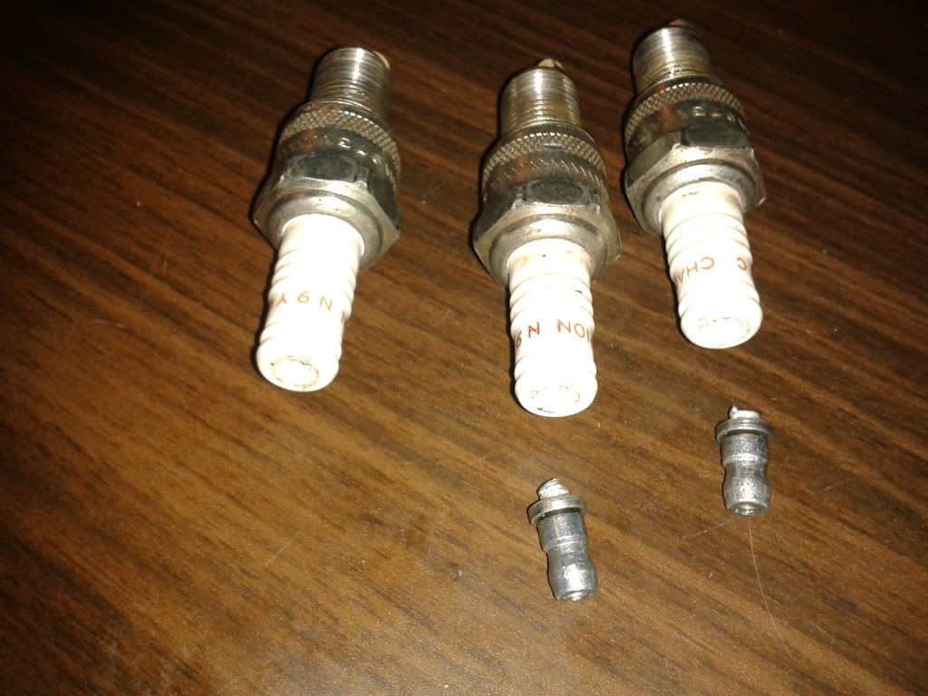

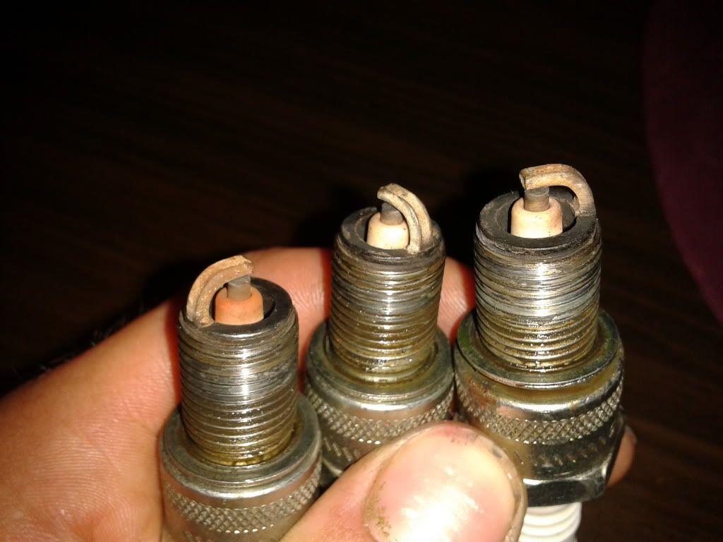

I then decided to check the plugs to see what they looked like...The fourth looked exactly the same.
What I did find when I removed them was this happend to 3 out of 4 of the plugs. Never had this before! *surprised*
This makes me think that maybe the plugs weren't firing on load? I also noticed an odd missfire whilst testing the pump, and a few drips of fuel coming out of the exhaust? *Confused*
One other thing I have noticed is that twice I have had a major shock from the HT leads when I was trying to get the engine started a while back (since then I have gone no where near them with the engine running!). The first time it happend it blew an LT wire off the coil, and made my arm ache for a long time after. Could this be down to poor insulation on the plugs or something else?

There's the problem right there, those plugs are Champions *tongue*
The colour of the plugs look about right.

I'd try some new plugs before anything else.

I don't think I have much choice now. lol
Has anyone had this with plugs before?
for the price of a set of plugs, fit NGK's

Ive had plugs break like that before on other cars. I just put it down to age or quality of plug.
