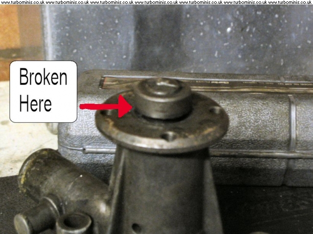

Anyone had a pump break like this before? It buggered my weekend at Loton Park.
nope, never. thats one piece. although it is only pressed on. I broke 3 water pumps on the weekend, (trying to turn down the impellors) but not like that
hell! not where you would think it would go.
fan belt too tight is the only think I can think off, or maybe the shaft was bent putting to much strain on things? dunno???
I don't run an alternator, so I have to squeze a belt on. It is quite tight I guess.
It's lasted 3 seasons before it bust.
Just another thing to put on the list of things to check for wear every winter.
Wil
wil I used to run autograss minis with no alternator, the way I did it was to dismantle an old dynamo right down to the bare bones and then modify the end case to give me basically a tensioner wheel to use with a std length belt? Did not weigh much at all by the time I had done it, I used to squeeze a short belt on like you say but had problems with it jumping off once or twice hence I moved to this set up.

Yeah Tom I've had problems in the past with the belt being thrown off. It turned out that the pully was buckled, never thrown one since the new pully has been fitted.
