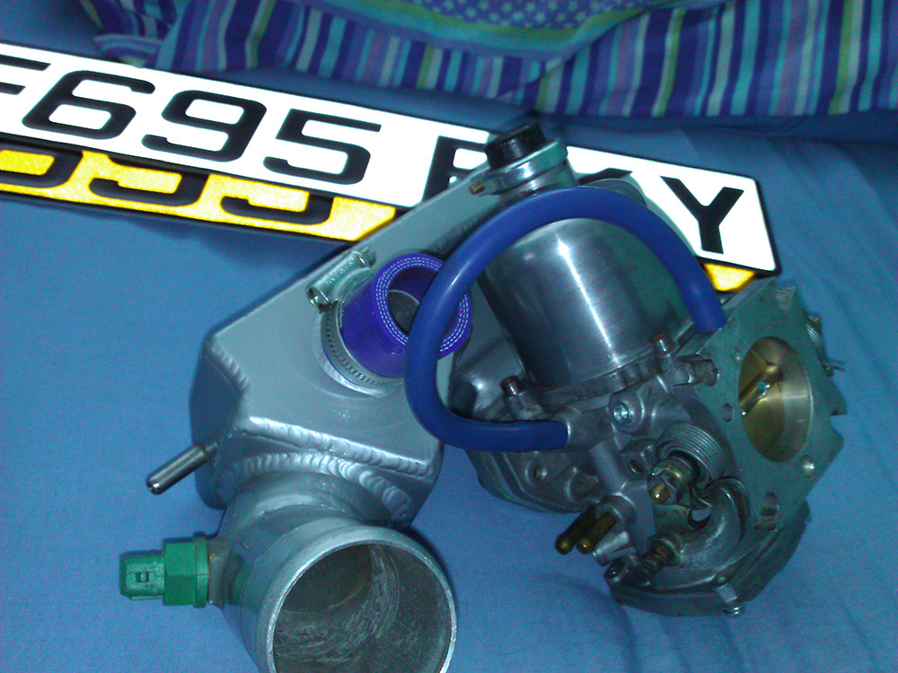

Part throttle lean off is the thin blue pipe in my picture, should be easy to find then :)

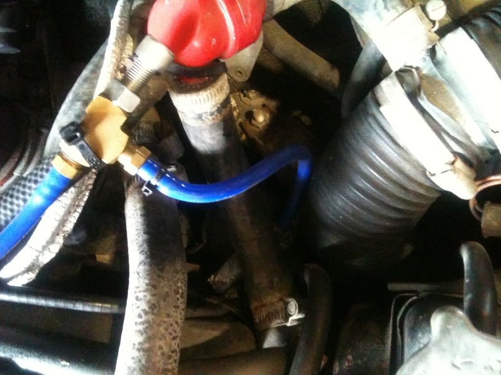

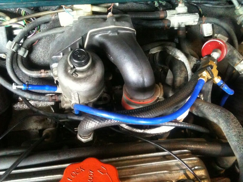

Here's some pic's of how it is now with the bleed off thing ? were would i put the pipe coming from the waste gate to ?

I cant tell from the pic where it goes at the carb end. Is it on the manifold or carb? It looks like it's on the carb.
Either way. That pipe should be plumbed into the fiiting on the compressor housing.

That is wrong that pipe should go from the actuator to the compressor housing, with the bleed valve fitted inline.

don't think who ever put that bleed thing on had a clude what they where doing ! they blocked the one off the compressor housing and took the waste gate pipe to the inlet manifold ! so i was getting full boost nearly a bar now i have 0.5 of a bar is that about rite ?

Get a pic from directly above the carb.

Cheers i'am at home now and the cars at work, I have the hose from the side carb going to the the front face were the carb bolts to the inlet manifold as in the first pic, the car now boost the about half a bar.
