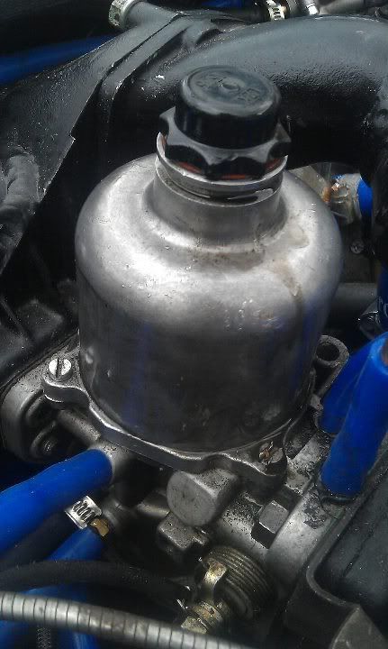

When cranking the car over with the intercooler off, I get a slight popping/backfiring through the carb around every half a second and puffs of smoke/vapour coming out the plenum, yesterday I tried it with it on, I could hear the popping/backfiring and can see this smoke/vapour rising from around the carb area, took my plunger out from my dashpot and all the smoke/vapour came out
Any ideas? Only thing I can think of is I took the carb off from the inlet and never changed the gasket for reasons I cannot remember, I can squeeze in a couple of hours later afterwork ill whip the carb off and change all the gaskets from inlet/carb/plenum see if this makes a difference, anybody got any other suggestions I could try?

You sure return & feed pipes are connected right? Fuel pressure? As you say, everything head upwards has been changed or revamped. I take it dizzy has not been taken out......if you replaced leads/cap, double check. If your unsure, get no.1 dtc, whip the rocker box off. Both valves closed, see where the rotor is pointing. I know it all sounds retard, but best check simple things first. :)

Fuel pressure reg is connected up fine I've double and triple checked, its brand new and set at 4PSI, yes dizzy has been out but all leads are on correctly firing order is correct I am just cleaning carb out with all new gaskets between manifold carb and plenum as we speak

Just turned the idle mixture screw out about 2 turns and it has cured the problem? Just a fueling issue by the looks of things lol
