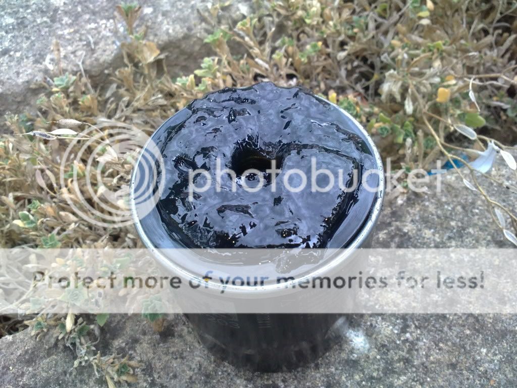

here you go, oil filter. same story for oil cooler + pipes
6752 Posts
blimey *surprised*

That's going to be a real PITA to get rid of.

looks like a rebuild is on the cards,
