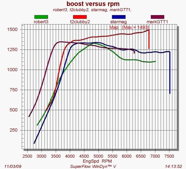

Only covered 250 miles so far with my new turbo engine, but already planning to change my T25 hybrid turbo. It starts building boost from 2.5k, but doesnt reach full boost (16psi) until 3.8k. Is this normal? Is rises progressivly ie. 4 psi @ 2.8k, 8psi @ 3.2k, 12 psi @ 3.4 until 16psi. It all happens very quickly, and makes the power delivery very smooth and tractable but I expected slightly less lag and I studden surge of boost.
Where does your boost start to build and peak? and with what turbo?

Thanks Paul, that sounds like the turbo is about right then? At what rpm is the gt17 at full boost (16psi).

If its a help, my gt17 is on a std mirage, some mods to the studs and a 3mm shave of the block, no bulkhead box on mine either, I cant really give an rpm off the top of me head but to me the 17 seems to build boost very quickly.
On 5th Oct, 2014 Shauna said:
The Morris Ital assassin!
heres a graph of boost rise ..its in mp but 1000 mp =15psi.
exhaust design (before and after the turbo)
timing
mixture
port size
cam timing
turbine housing
these are just a few of the things that will affect the boost rise . im on a gt17 and its the green line in the graph . as an interesting example , a richer mixture on my car offset the boost rise by 200 rpm.

Looking at the graph mines boosts up just like the red, green and blue lines. Panic over.

What turbo is each off the cars running?
Edited by alaskanow0 on 25th Aug, 2011.
Robert gt 17, mark clbygtt t3, kean t2 t2clby and at that time arron had a t3 starmag

So why does the T3 appear to boost earlier than the T2 & GT17? (rich mixture granted). It appears to be 400 revs earlier almost everywhere. Is this a bigger displacement 1380?
sturgeo
857 Posts
Member #: 1778
Northants
It's a 1380
yep makes a big difference.

Mine was not a standard T2 in that graph, it had a larger compressor wheel.

Kean, was it just the wheel or the housing aswel. I'm thinking of swapping back to just a t25 wheel.
Kean
2406 Posts
Member #: 341
aka T2clubby
South Staffs
Wheel and housing mate
