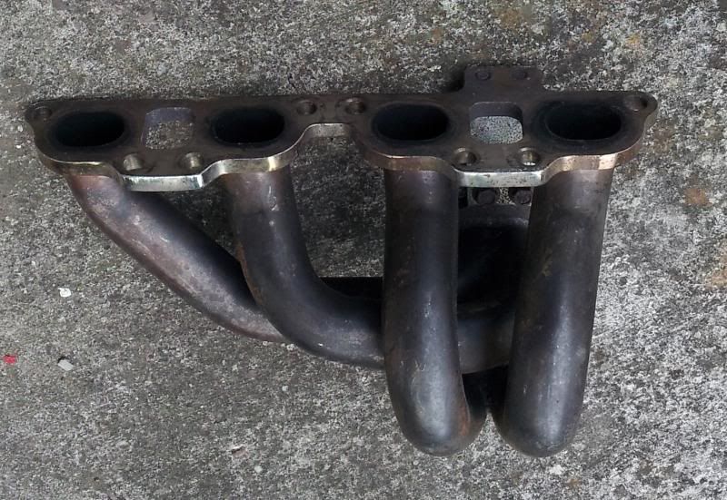

Picking up a stainless manifold for my other car tomorrow, is there any way of cleaning them up easily so they're shiney again?
Those little sanding sponges will do it with a little elbow grease.

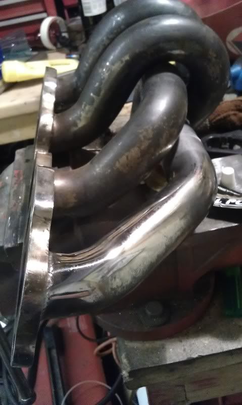

i want a nice mirror finish. got all the tarnishing off now with some 800 wet, polished up the easy bits with autosol but going to get the polishing wheels on the rest.
Knackered now though after spending all evening polishing my pipe *wink*
