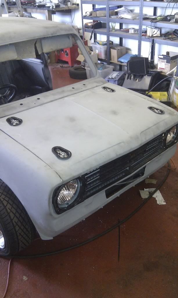

Here's how I have done mine, you will have to mount yours more on the top if using your hinges to allow the bonnet to close.
If you look at the front corners of the bonnet.
On 15th Mar, 2012 wil_h said:
On 30th Apr, 2012 Brett said:
if you want to use the pins in the photo with the bonnet still on hinges, you are going to have to fit them up on the top of the bonnet before it curves down to the grille. There are other types of fitting you could use that would allow the bonnet to open on the hinges but i'll not go into them right now.

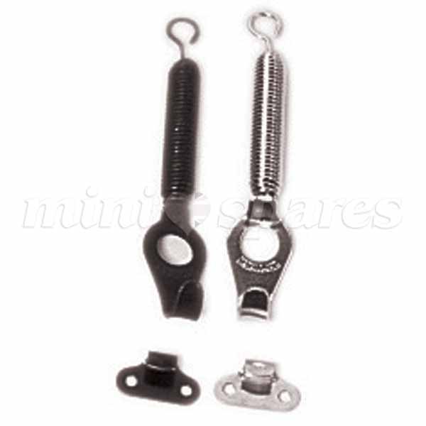

alternatively, you could fit external straps or springs such as these
http://www.minispares.com/Product.aspx?ty=...id=36577&title=
http://www.minispares.com/Product.aspx?ty=...id=37720&title=

As per your recommendations i have ordered the bonnet spring.
but i cant seem to understand how to install them.
If you have any insight on that please share. i will upload pictures of the kit i received in a couple of minutes

You mount the 2 small seperate prices onto your bonnet, and the 2 springs on your front panel, then they hook over to close.
Like this mate,

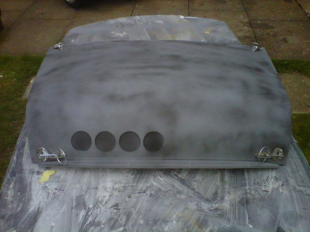

An option is to get the extra bits that allow the bonnet pins to be sunk into the bonnet. Easy on a clubby.. less on a round nose.
Crappy picture: (not finished but you get the idea)
http://i1230.photobucket.com/albums/ee481/...ld/IMAG0397.jpg

aero catches
Ive seen the round based bonnet pins on the very front used, and just the opening filed down a bit to allow the pins to slide through when theyre bolted to the top of the slam panel. If i see my mate soon ill get a pic up.
