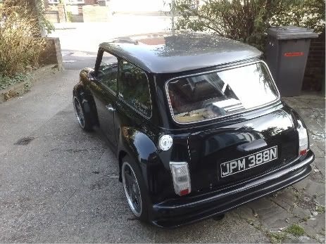

I have sprayed cellulose and will never go there again you have to apply too many coats to allow you to cut it back to a dive in deep full colour shine.
2k goes on heavy and gives great coverage from the first coat, continued polishing will see you removing the paint down to the primer in time.
The only way is clear over base
The colour for 2010-2012
And this was it for 2008-2010
2k will not look half as good after 1 year and you will be touching up chips, cracks and crazing with cellulose until you realise your mistake and turn to clear over base.
