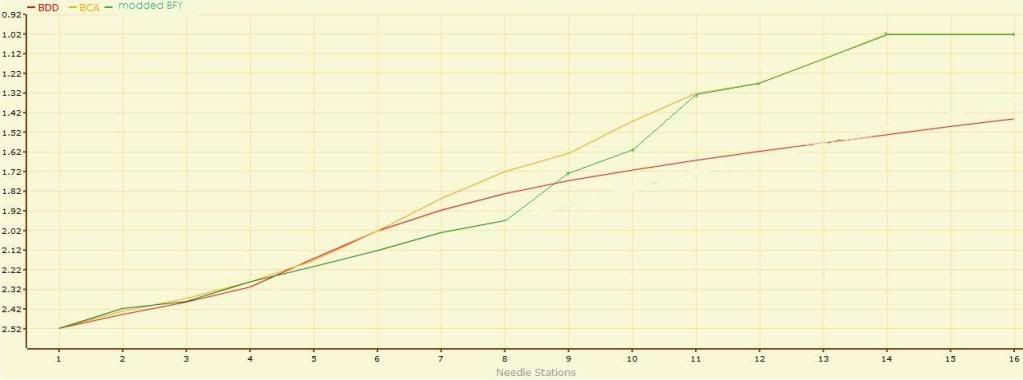

could be a long shot, but dont suppose anyone has got the measurements of the 16 stations on a standard BDD needle?

Try
Mintylamb website
http://www.mintylamb.co.uk/suneedle/

matt thats bang on cheers buddy.

the bdd and bca are very similar upto station 6, which is strange as a few have said the bca is too rich at cruise?

Im sure cruise must move to 6-7 under light throttle, as my car is now 12-1 at cruise with bdd, compared to 10.5.

yeah probably, i have got a BFY needle which came out of a na 1275, it is 0.10-0.15 slimmer than a BDD at stations 6-7, plan is to keep stations 1-7 the same then profile 8-16 more like a BCA, like so...
not sure if i shall have to richen it up a little around the middle, who knows, see how it goes.

Interesting, I also found bca very rich at 8-14psi of boost. What boost you running?

ill be running upto and around 18psi, i think ill leave it a tad leaner than that, maybe 0.05-0.03mm, which according to turbo tel should equate to around 1 on the AFR, give me a little for fine tuning.
