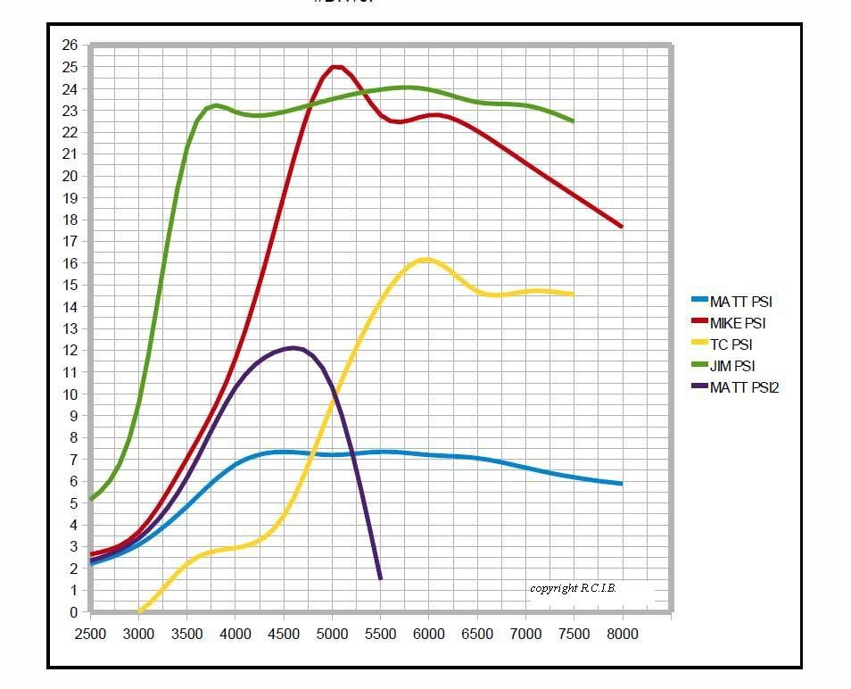

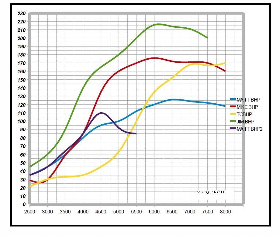

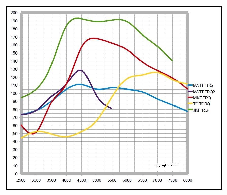

Here are some of Roberts excelent graphs from the dyno shoot out back in 2009 (has it been that long!!) Power and torque at the hubs, not the wheel, nor the flywheel (basically no tyre drag)
