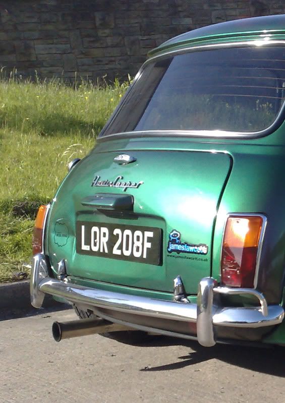

When a guy drove into the back of me, i was lucky he wanted to settle it without insurance because that was my main worry it being wrote off, and with the help of Rick on here doing me a quote i was able to buy a new boot and it paid for other bits too. My rear valance and rear panel was pushed in, but it all pulled out straight.
What i didnt plan was taking it off the road and doing a full vtec turbo conversion at the same time and spending £13k!
