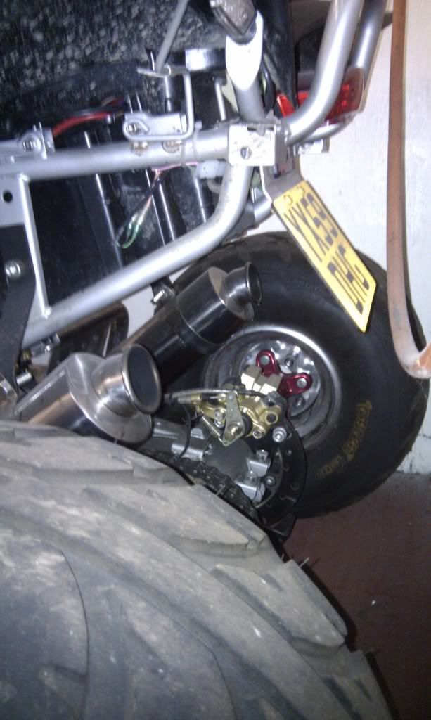

As I have a quad with one of those weird combo callipers on the back I'll post up some measurements at the weekend..

Well, for reference in case you do go down that route, the one on my quad is about £90 new (p/n 31360-A12-000 I think), they are used on a few different manufacturers so it might be possible to get 2nd hand ones.. never tried.
What about pad material on the quad calipers? is it up to the job of the heaver car and the faster speed

Quad 180kg, me another 110kg, pillion?kg on a single caliper. It goes to over 120mph due to the stupid engine I've put in it. Never fails to work. The front ones get F hot and fade (about 4" disks!) but the back saves me! It is probably going to be on the limit with 2 on the back of a mini, I wouldn't use it for racing.
the Kad pads are kwaka 600cc bike pads albeit they are available in different compounds,
nope, sorry I'm talking bolocks, these are the puppys...
http://www.ebay.co.uk/itm/360383818833?ssP...984.m1423.l2649
