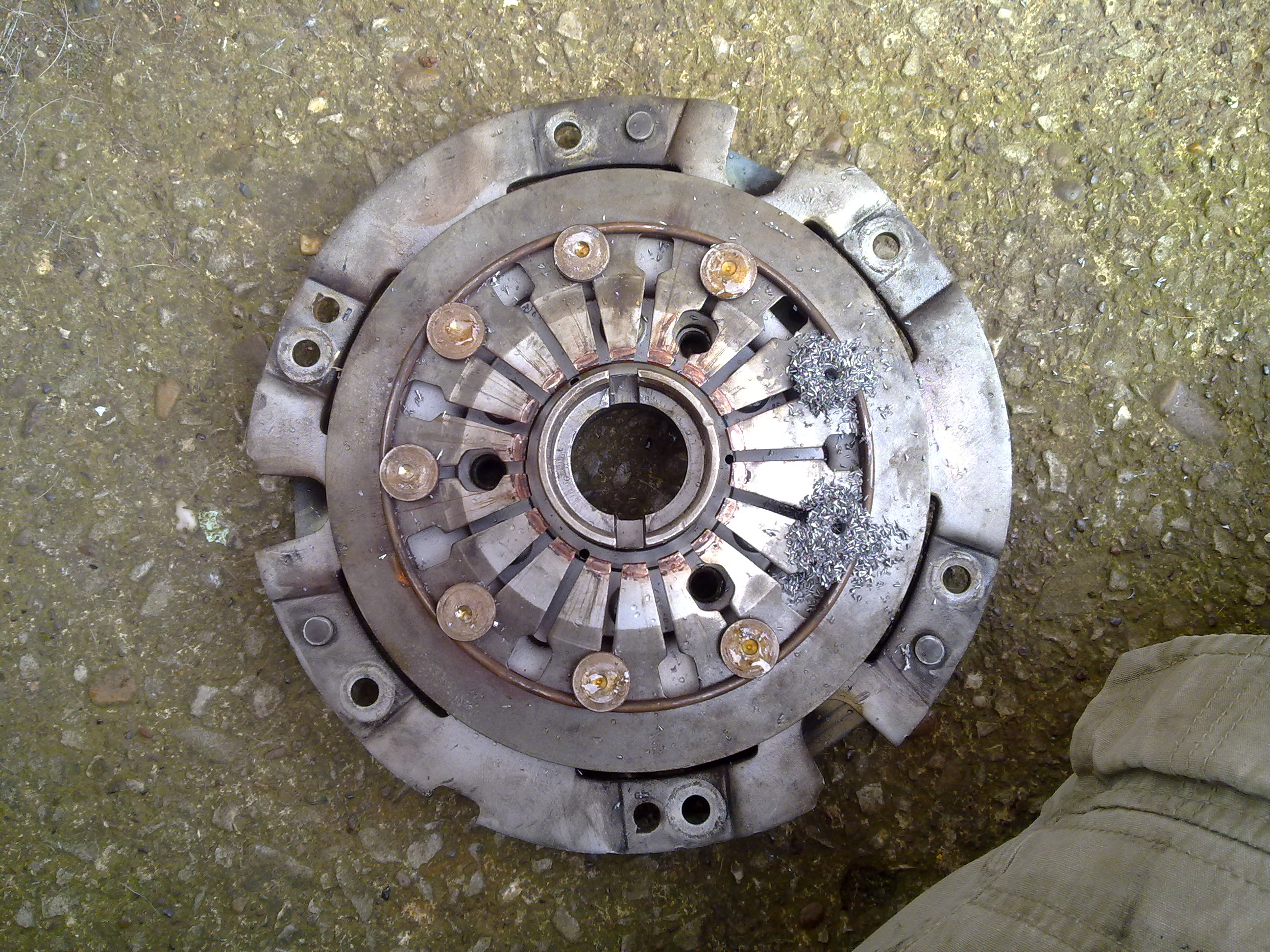

not to sound like a tool but whats the valeo one look like? any pics of them?iam sure mine look like the ones in the pics above thanks scott |
![]() 8297 Posts Member #: 408 Turbo Love Palace Fool Aylesbury |
4th Oct, 2011 at 04:31:56pm
Like this.

Like this. ![]() That looks very much like an AP clutch to me Matty

4th Oct, 2011 at 09:22:47pm
Please note, I have seen some AP clutches without the metal retaining ring, and those I believe to be from the 998's Edited by Sprocket on 4th Oct, 2011. On 26th Oct, 2004 TurboDave16v said:

Ah I always thought mine was a valeo, as the other clutch I had, had slightly smaller spring plates and the metal retaining plate instead of the wire ring.

On 4th Oct, 2011 Sprocket said:
Please note, I have seen some AP clutches without the metal retaining ring, and those I believe to be from the 998's Yes i moved to the darkside |
