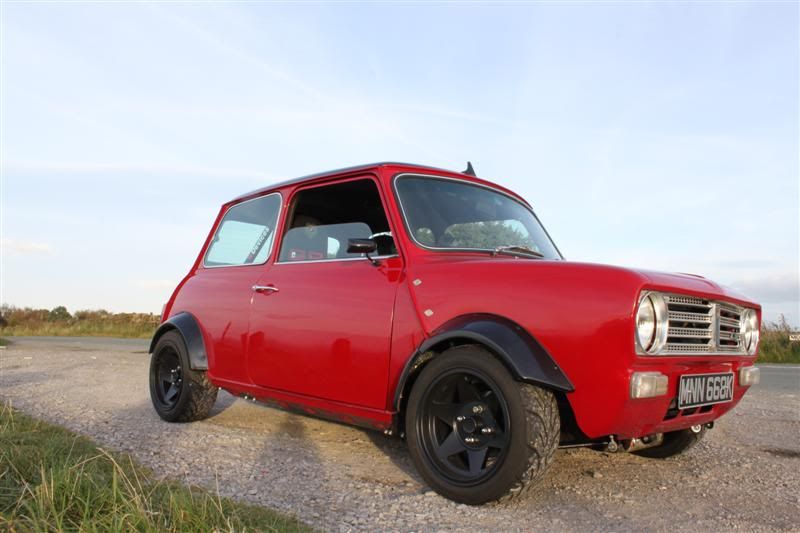

i cut the front edge off a set of grp5 euro's to fit my old clubby when it was on 13's

I do like that clubby, it looks sweet!

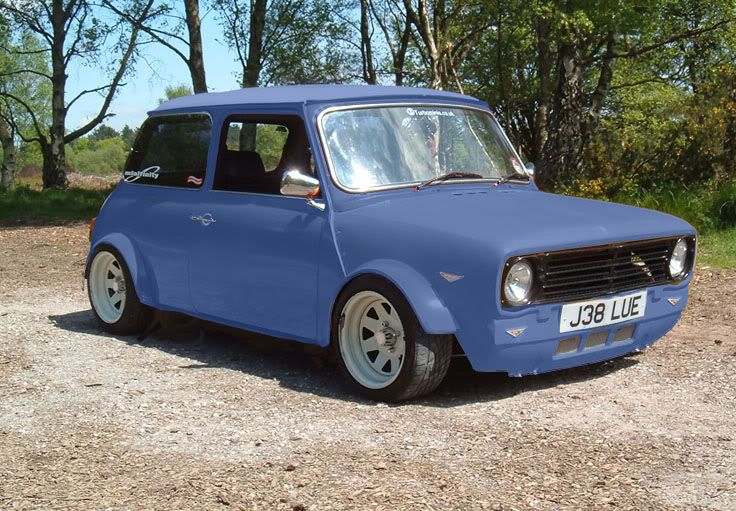

that is a verry nice clubman
Done now needs redoing lol

i was always tempted to paint it that colour, but matt black turned out to be cheaper and quicker, lol.
Well I use mig arches with the front trimmed off. They do have visible screws, but with a bit of GRP work it would be easy to fit mounts so you dont have to.
It may well be possible to trim some sportspack arches up, then remould the edge, but I have no idea if it would look good or not.
