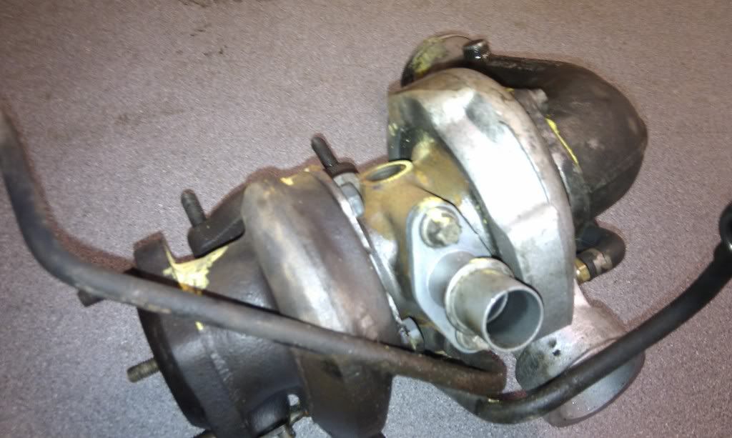

Hi not the best pics but can anyone tell if this is a gt1752 been told that it came from a saab 93 2.0L
Thanks for any help Craig

Looks like it, what are the numbers on it?
Looks like one to me.

Couldn't find any numbers on it will go back in the morning. Any idears where to look for the numbers
Craig
That don't look right to me. Similar but not the same as the Gt1752 in my hand.

Got a picture of one on my phone on ebay while i was their and it did not look the same to me. but was not sure

Could it be gt15
Craig
Looks like a T25 from a Saab Aero to me.
I've been fobbed off with a couple of these as GT17's before.
Yes, the Gt1752 does not have a circlip secured compressor housing.
The air feed on a 17 is a clamp on. that appears to be bolted on

Thanks I'll keep looking then guys
This is the easiest way to tell between the two in most photos.

That air inlet looks exactly like the one on the GT 17 I fitted and looks like it has a V band connection, as did mine. (I cut down the alloy casting and made a useful inlet from it)
It's very similar, but the T25 bolts on rather than using a v band.
