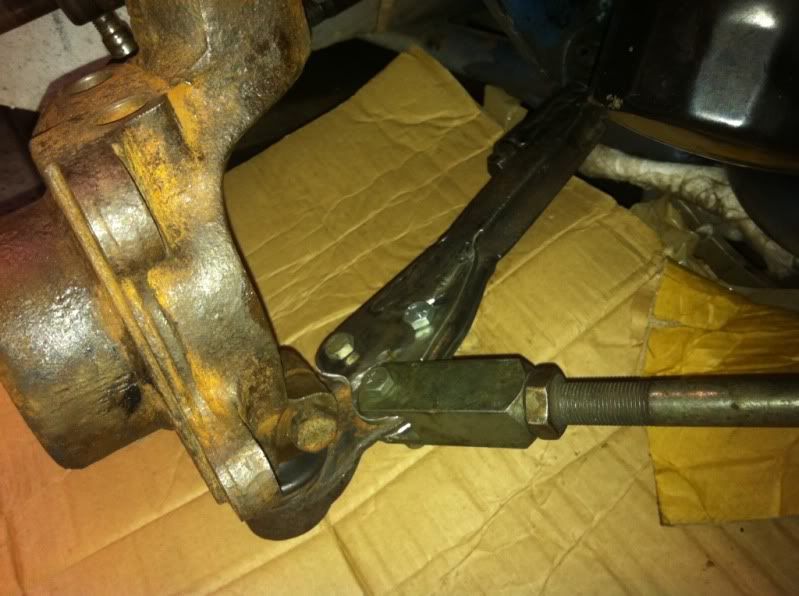

The article u read had great photos
Shaft seems nice and snug
