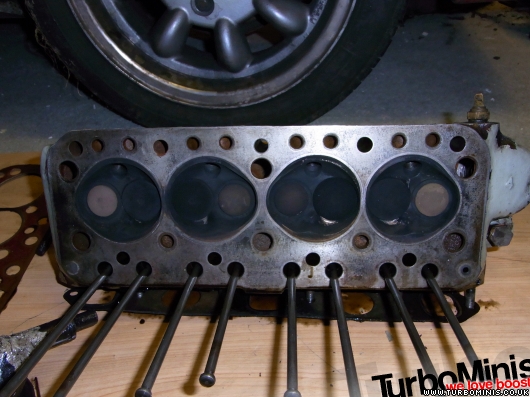

Any chance of a photo of the cylinder head chambers as a point of reference?

I'll get one later, there is an obviouse differance that shows that the differance is possibly worse than a carb. Whch is interesting.
Head photo
Not bad at all really will, and if the cr's lower then the boost ca go up.lol

That doesn't look any worse than mine to be honest.

Head photo
No, not too bad, although I would say that the outers are around stoich and the inners quite rich.
What do you think the AFR spread is then ?
What are those shiney areas near the inlet valves, clean metal?
Edited by Paul S on 27th Oct, 2011.

Paul - Not sure what the shiney bits are, flash related bright spots, not obvious on the head. Not suer about AFR spread, but it runs rich im most areas at the moment, this is because of the amazing breathing system I developed to get rid of the smoke.
