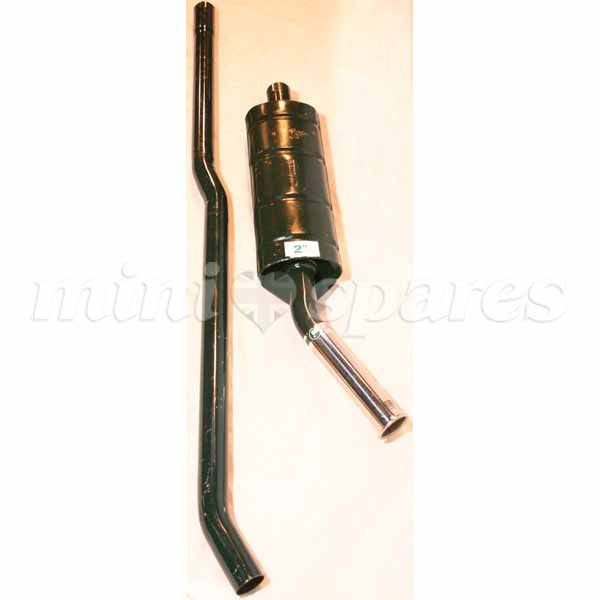

sorry for the really stupid (and hopefully easy to answer) question but just cant get my head around fitting this exhaust:
i cant seem to find any fitting kit for a 2" exhaust and this exhaust doesn't have a hanging bracket so just confuses me even more, if anyone knows what brackets and other bits i need it would help me so much as fitting this is the last thing i need to do to get my mini back on the road
cheers all
Call Maniflow and ask for the centre mount bracket and rear mount bracket. theyre similar to the standard earlier mounts
Im pretty sure you would need something similar to this chap. Double check the sizes and what you would definately need!
http://www.minisport.com/mini-spare-parts/info_EXHFIT02.html
Edited by Carlzilla on 22nd Nov, 2011.
Like these
http://www.minispares.com/Product.aspx?ty=...id=36486&title=
http://www.minispares.com/Product.aspx?ty=...id=34446&title=

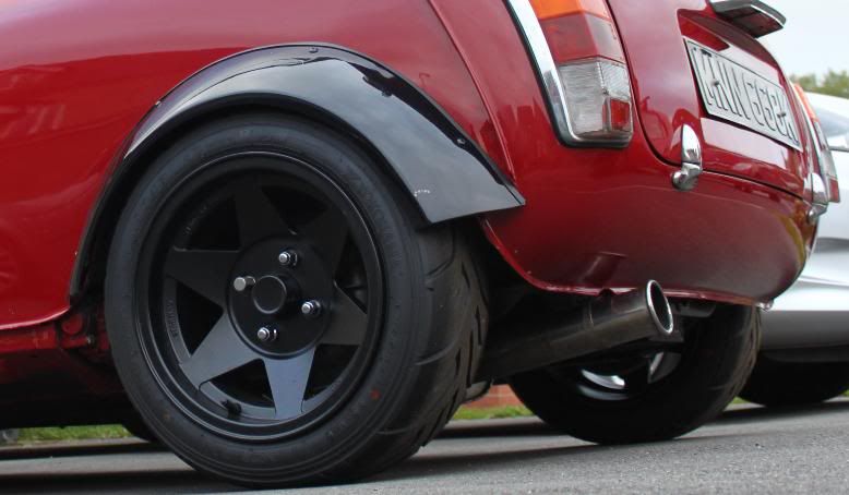

cheers for the replys, will give maniflow a ring just need it for the weekend, as for cotton reel bits and stuff like that just cant get my head around how it all fits, when it comes to exhausts my brain falls apart, anyone have a picture to hand of a similarly mounted system just so i can get an idea of how it all fits together
(Taken from http://myminiproject.co.uk/lucy/mini41.html)
Looking at the back of the mini:
Rear mount
Front mount
Then the clamps go around the exhaust and over the curved bracket, and tighten up, job done!
How it should look when youre done:
A Haynes manual will show how its done
You want two of these for the rear mount
http://www.minispares.com/Product.aspx?ty=...id=36506&title=
And one of these for the centre mount
http://www.minispares.com/Product.aspx?ty=...id=35703&title=
For what it's worth, I used a jubilee clip here rather than the exhaust U-bolt bracket, just looked a bit tidier IMO (and it's been more than up to the job supporting a 2" Play Mini system)
Not a problem!
Pottsys jubilee looks far tidier! Almost un-noticeable infact, but im guessing that's a slightly upper class stainless jubilee as opposed to the standard jobbie? *tongue*
Have used jubilees there in the past. Always been fine and as Potsy says, much neater.
