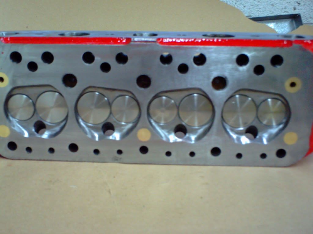

I think wat il do is get head ported and polished. what is a safe size to take the cambers out to so that i can maybe up the boost to around 14/15psi
is there anyone got any pictures of a head after its been done?

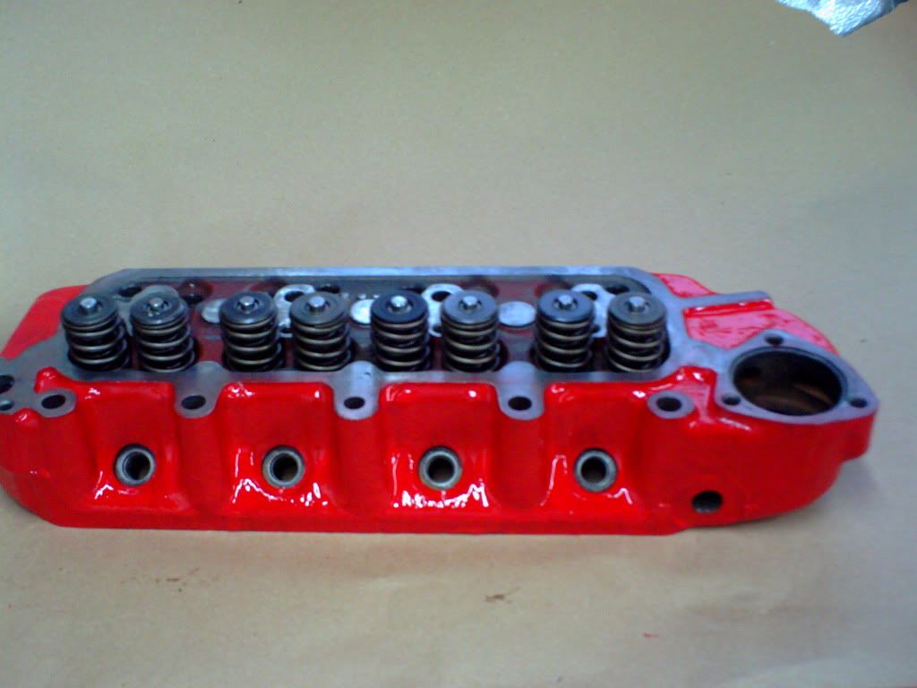

Here's a pic of my benross head this is the man for the job
Craig
