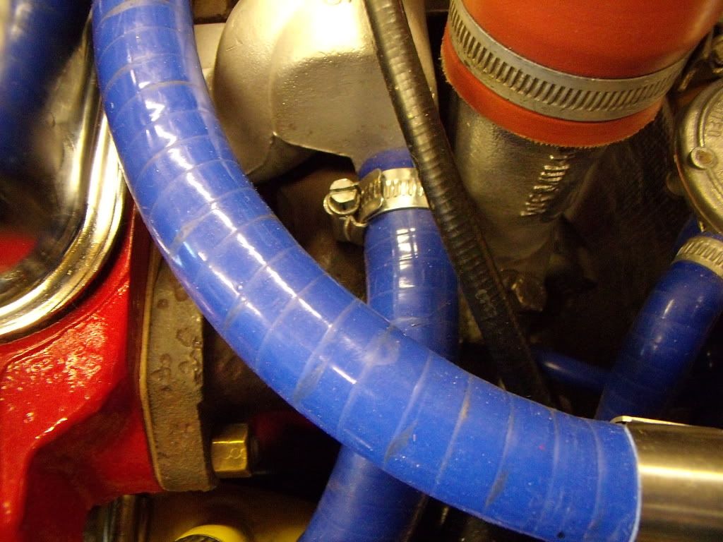

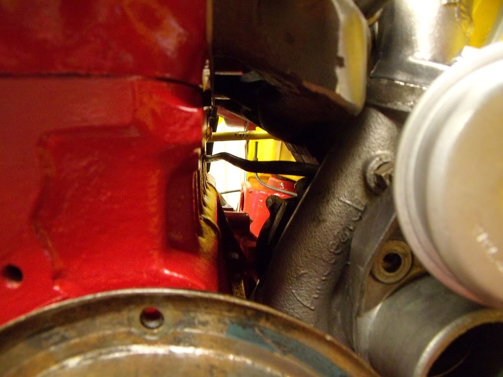

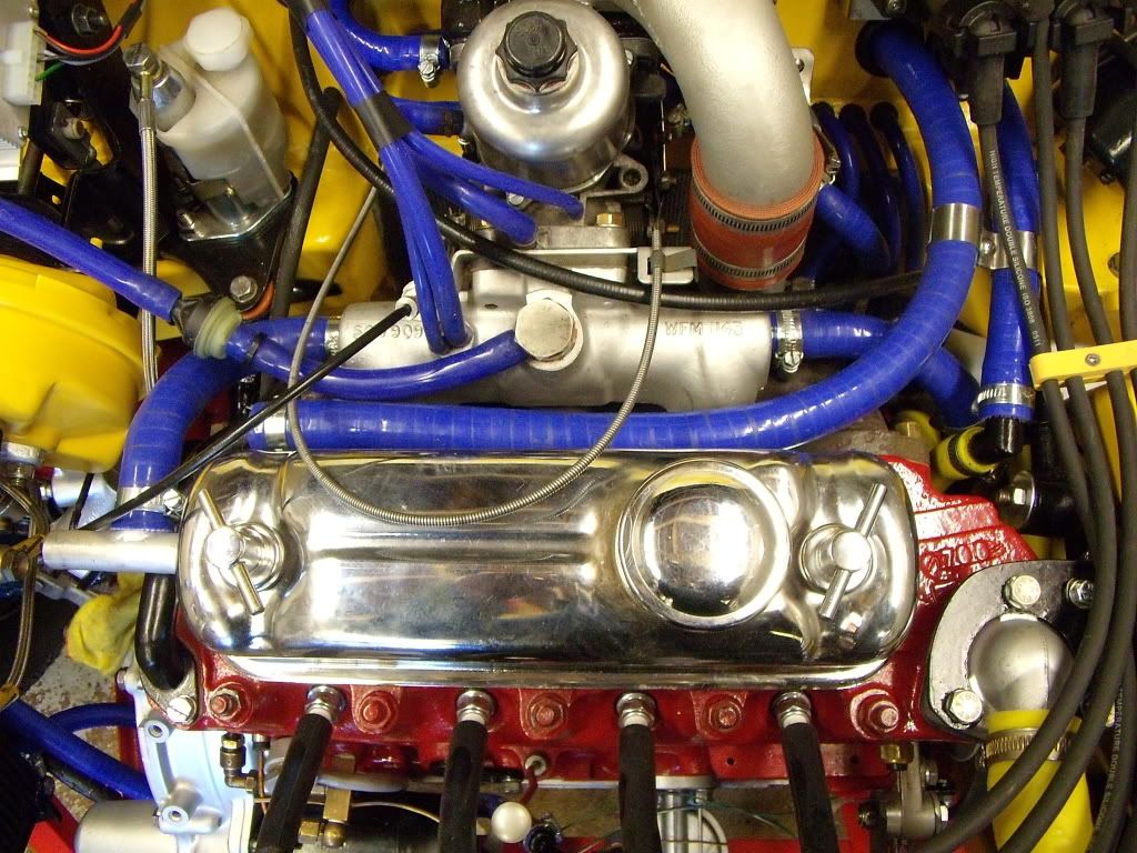

Yes it does mate already fitted now and engine running OK, can feel gases being emitted from pipe at the end of rocker cover..
This is a pic i took earlier in the build..
This is where it goes through the inlet manifold
Out to rocker cover
Want to make a catcher tank, and if it were possible drain back into sump through old distributer hole..
Hope you can see what i mean.. Alan
