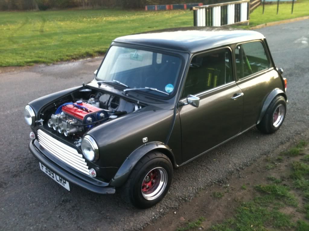

photos of 7's on mine
http://www.turbominis.co.uk/forums/index.php?p=vt&tid=292045
mw3
684 Posts
Member #: 9590
Derby
They dont stick out too much
