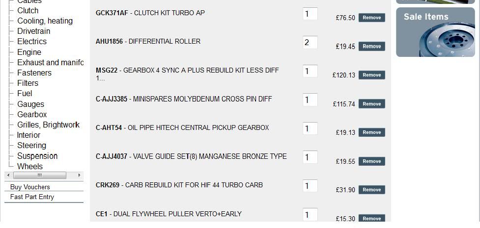

Would the rebuild kit listed below replace all the bearing you mentioned brett.
Just out of interest, hows your box holding up to that sort of power.
Im just getting a list of a few things i need for the rebuild so im planning on making an order with minispares tonight while the sale is on, just want to make sure the parts i have are suitable and if there actually the right ones, im not too sure if the clutch kit is right,
this is a copy of my shopping cart,
http://i1226.photobucket.com/albums/ee420/jdisel1/ii.jpg
I know theres loads of other bits to get, i just want to get the more expensive bits now to save me a bit of dosh in the long run.So if these any other obvious parts, shout,
Any help would be great *happy*
Oh ya, what cam followers would be the best, would the stand ones do the job or are the ones with the holes be better and what about a duplex timing set, do minispares do any performance ones, Another thing, these a valve spring missing on my 12g295 so would it be worth just getting a full set new, I also need a few tools for the rebuild, just wondering what sort of things i might need, I know i need a set of taps, callipers, dial guage,but other that that im a bit lost.*tongue*

On 10th Dec, 2011 jdisel said:
Cheers for the link
Well I would not be happy putting more then 120 though even a well reconditioned helical box.

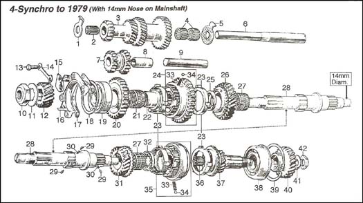

On 11th Dec, 2011 Sprocket said:
we'll see how I get on in the coming year then *hehe!*
On 11th Dec, 2011 minimole23 said:
Bang, grind followed by 'oh bollocks' I think!
Maybe.
One question though did that ^^ transmission have the KAD pinion support, swiftune layshaft, all end floats and the side clearance on each gear on the main shaft, set to bottom limit, and gear dependant boost control?
*happy*
I'll still likely break it though
Oh, and those gears ^^ look particulary well used
Edited by Sprocket on 11th Dec, 2011.
4309 Posts
Maybe.
*happy*
It lived on a 998 for 60k before being rebuilt by someone who seriously knows their onions and fitted to a n/a 1380. Since the rebuild it covered about 40 miles around castle combe and 15 drag runs. The driver does not understand what mechanical sympathy is though which may not help!
there you go, 60k miles. The transmission is already pre stressed *happy*
A 998 couldn't stress a plastic gearset *tongue*
