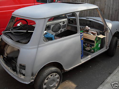

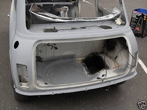

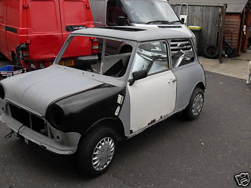

Hello there everyone.
This has been my first project I have ever taken on and its defiantly had it's ups and downs. But I have enjoyed every second if it so far.
I have been working on my mini for about a year or so now.
Just thought it was about time I posted up some photo's of how the project is going so far.
I hope that you all like it and I would very much appreciate any comments or constructive criticism.

There are so many more photos and its a lot more complete than that. I'm just having a bit of trouble uploading all the photo's.
I will get the photo's on soon i hope
