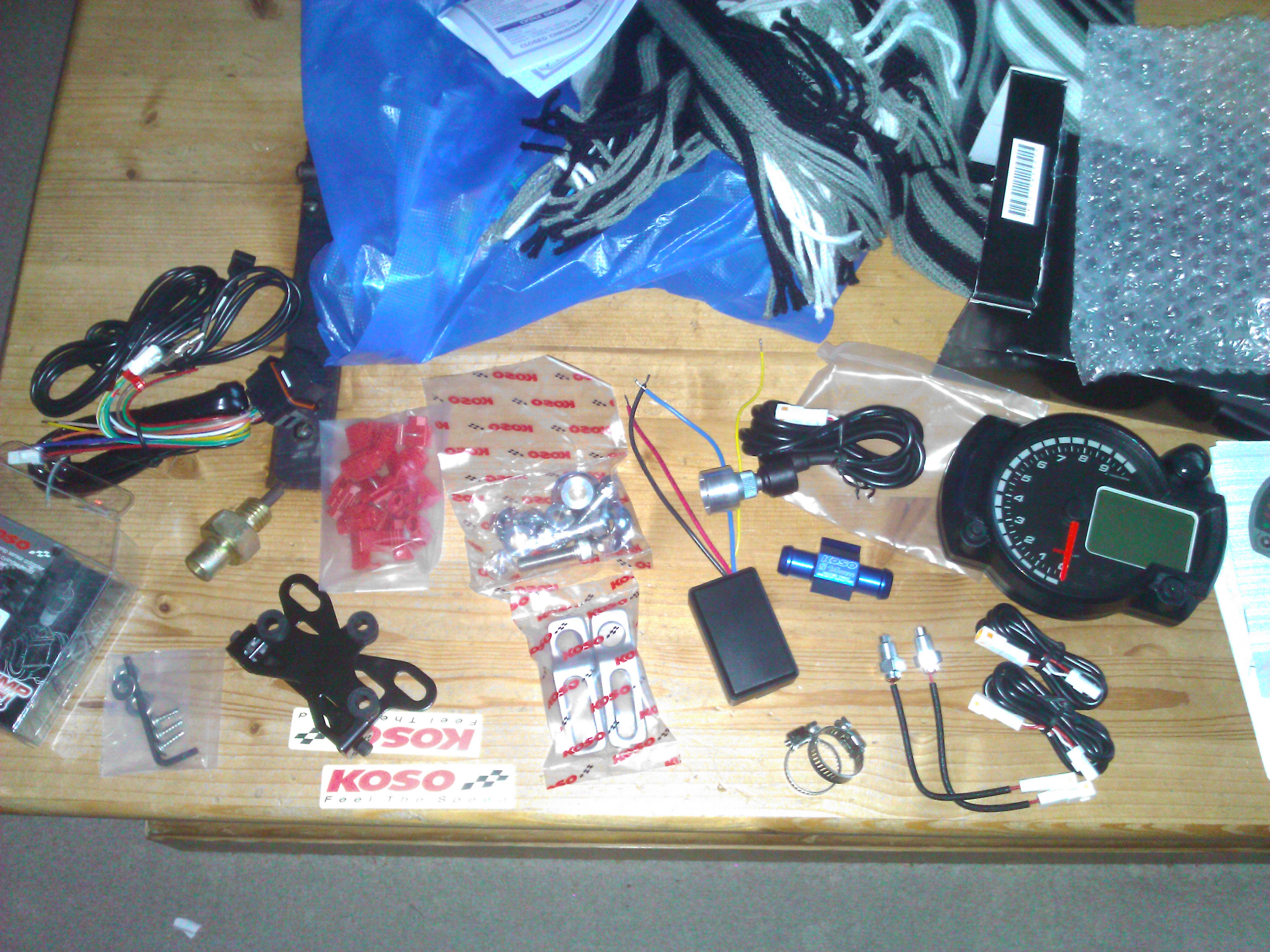

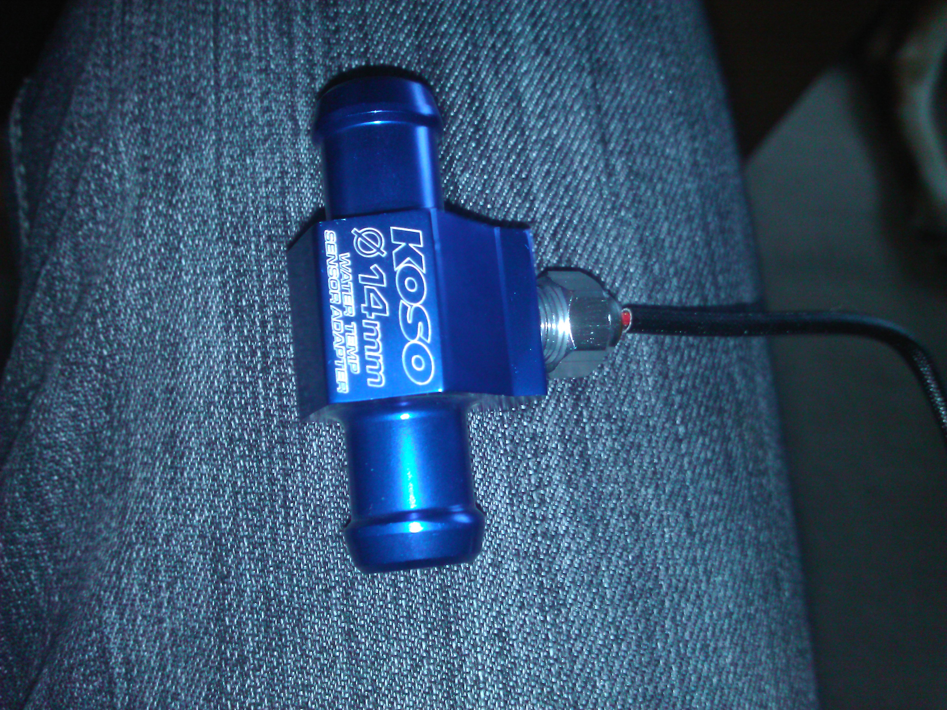

Digidash turned up today, Very pleased with it and the service from digital speedos. So much stuff to get my head around, and all the settings on the dash i need to play with when it's eventually fitted. I like looking at the water temp sender adaptor *tongue*

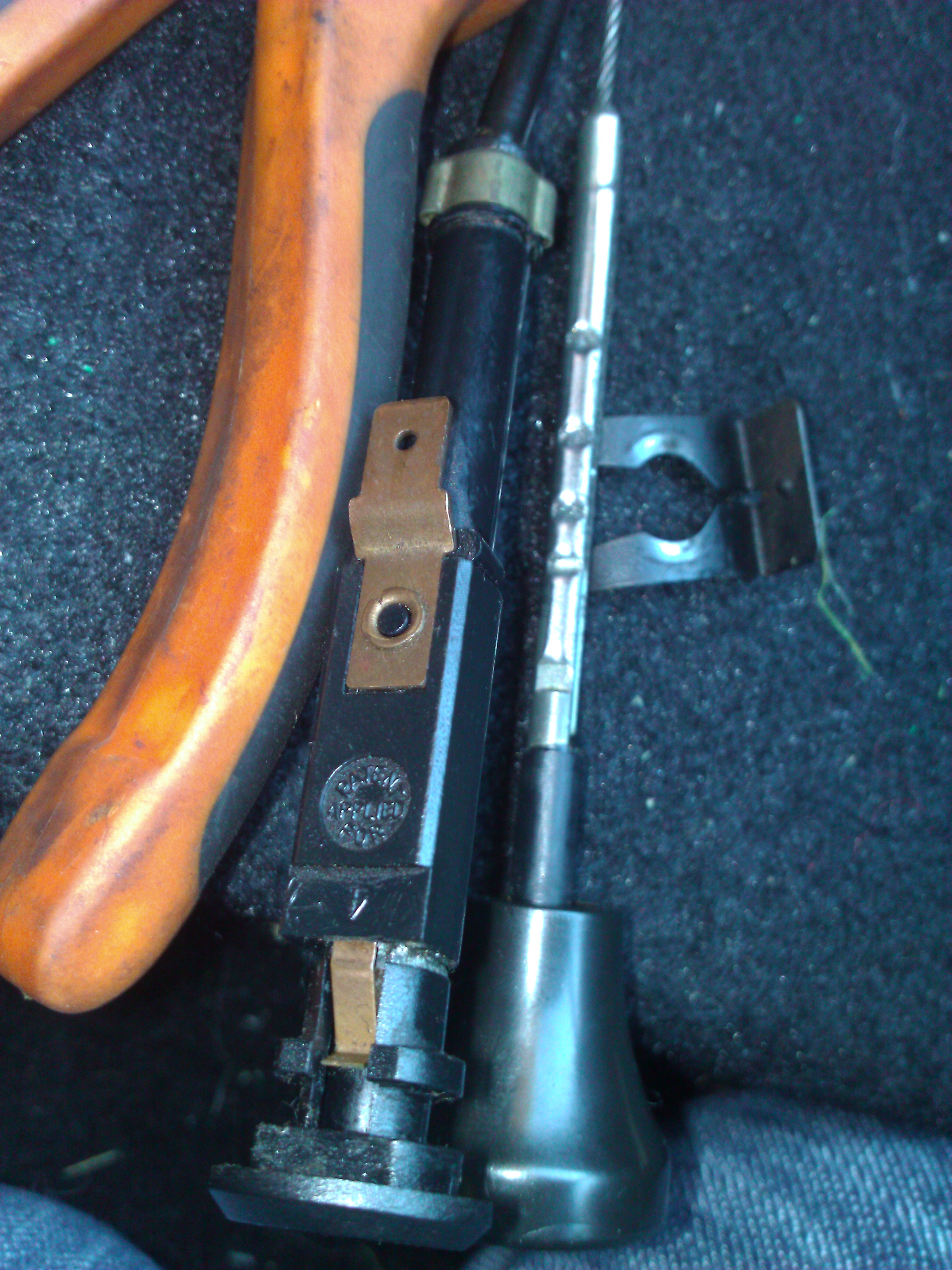

But, taking the heater and clutch cables out i found something odd, which looked like a switch of some description on my choke cable. It wasnt connected to anything though.
Is this off a metro?
I'm guessing that you connect to that spade terminal the earth of a tell tale light, when pushed fully in the contact is on the plastic shoulder of the cable and the light isnt on. But pulled out it uses the choke cable as earth telling you you've left your choke on?

Theres a light on the dash on metros so when you pull the choke out the light comes on to tell you what you just done. *Clapping*
Lol, i was just wondering where it originated from haha. Bit daft really, i can understand if its an auto choke, but on a manual? :S
I wonder how many people actually relied on that light when the car started driving like a piece of crap before they realised they'd left the choke on....
