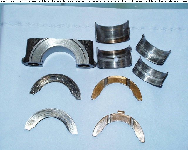

It's when the revs drop by 1000 rpm or so you need to worry.
I seem to remember someone called egvard or somet like that showed a picture (only once) of some goosed thrusts?

Oh yes. i wass unlucky enoght to experience dis myself. Hadto change the trustwashas. They was so badly done.

Greys will eat your thrust washers... but then again without an uprated clutch you will not transmit engine power to the road!!

ok cool, so a yearly strip and check is in order for definate then?

A bit like thi. The thrusts on the left and right should look similar.

Mine were goosed as well Homepage is funnily enough down, so ni pictures.
Check crankshaft endfloat VERY carefully, and make sure that the diaphragm springs is completely flat. If you're running less then 10psi of boost I bet that an orange will suffice. I haven't tried, just comparing to N/A torque demands.
