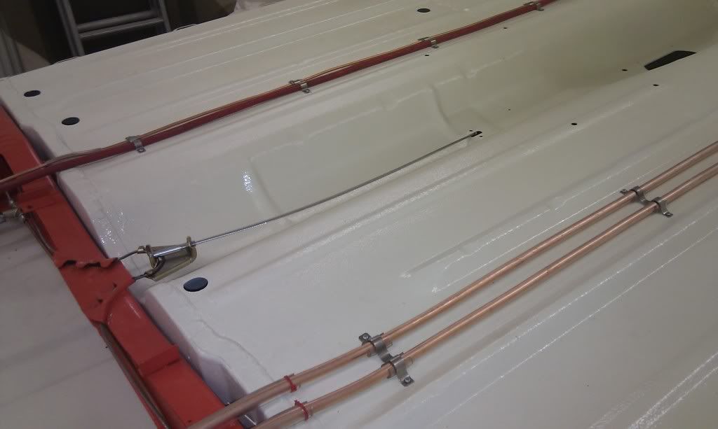

Basically I am debating whether to remove the old Fuel and brake line holders on the underside of the floor and replace them for clips, and need to make my mind up pretty snappy before i paint the underside, So.......
Removing the Factory fit ones;
And replacing with something like these (Sorry I cant remember whose post i grabbed this pic from a while ago but I like them)
Where can I buy some like the clips above or similar and do you think its worth doing ? I am going to be renewing ALL brake and Fuel Lines.

They are called P clips, just google that.
I got mine from ebay but your local motor factor might have them

I thought they where, wasn't sure if they where "P Clips" or fixed on both side like a Saddle used on Conduit.
Wicked so just these;
http://www.ebay.co.uk/itm/10mm-RUBBER-LINE...=item3ca2746538

If you are using all standard pipes then I'd be tempted to stick with what's there, but if using large bore pipe then using P-clips is a neeter solution.
The only thing with P clips is that the fixing comes through the floor causing a place for rust to start plus the end of a self tapping screw can look ugly so a small nut and bolt would look better
Ive just bought some plactic P clips from ebay. Im planning on welding some M6 nuts to the underside of the floor as my fuel lines are routed inside. I agree with Paul, that self tappers through the floor are a bit nasty and prone to causing rust.
I fixed mine with rivets and sealed the holes with paint and a dod of wax to finish. You can see the rivet come through but its not bad
I like the look of that!
Me too
Why not use rivets instead of self tappers?
For how often theyre going to come off i'd have thought it would be a tad more waterproof if you put a dab of silicone over the hole before fixing down, then wipe off the excess?

Quick question, if you use self tappers, does the end come through the floor on the inside?
Speed doesn't kill, suddenly becoming stationary, now that's what'll get ya!
Yeah it would. You could use the rivets from the inside out if you have an extra pair of hands

I have used Rivnuts to hold mine.
