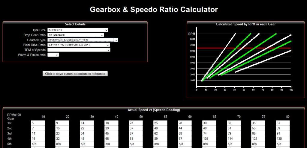

im looking at the ST Abingdon mini spares gear set but im worried with my 3.647 dif first gear will be to tall?
green is my curent ratios stock gear set with 3.647 diff
white is Abingdon ratios with 3.647 diff
first gear seems to tall in the graph as i have tryed to take off in my current 2nd gear witch was hard i could do it but had to ride the clutch to much for my liking if i was to do it all the time.. however in the graph 2nd gear is not as tall as 1st it might be ok?

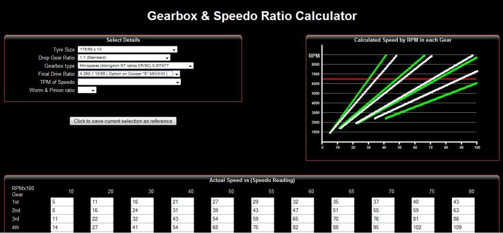

green is my current ratios stock gear set with 3.647 diff
white is abingdon ratios with 4.350 diff
on the 4.350 diff it looks a lot better with 1st being a tad taller and 3rd a touch shorter
