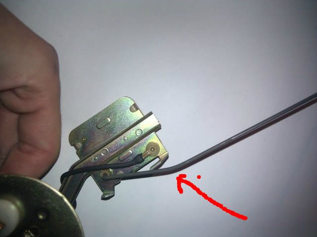

As far as I'm aware, the kink is just to avoid the intank pump. Don't hold me to that though.
If anybody is interested, they do fit, just copy the bends from an injection tank sender!
Saved myself a few quid for 5 minutes work *happy*

Hi Carl I'm in the same situation how did you know where the bends were?
Take the old sender out and bend the new one to match. *wink*
You can see on minispares picture where they are if you haven't got the old one.

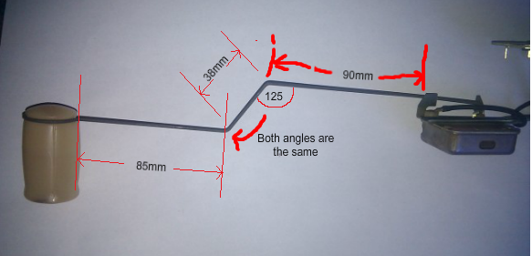

Somebody on tmf kindly measured one up for me
Measurement near the sender taken from this bend:
Will this not make it show worng as its now shorter?
Yes, but the half should be exactly the same, which is the bit im interested in, and lets be honest, mini senders arent all that accurate anyway. But at least its much harder to run out of fuel that way as it'll show empty when theres a little left, but it'll stay showing full for a bit longer. But, for saving £15 im not fussed because i already have a brand new sender in my non injection tank :)

Just measured my tank sender, the injection one is 10mm longer according to the measurements, so really is no difference in it!
