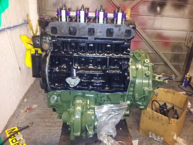

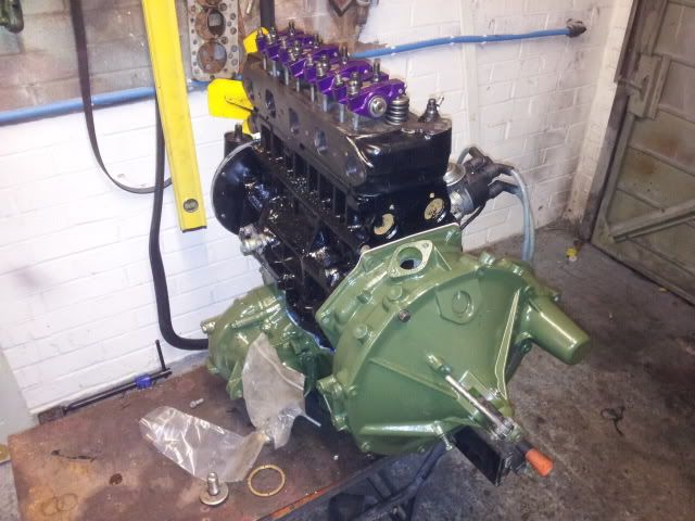

Its been over a year since she last was on the road. But all the drama aside and christmas spent with spanner in hand has been paid back by my little beauty firing back to life. The re-built engine spec is as follows.
Plus 20 11cc 20831 pistons
Mini speed turbo cam shaft
ported not polished head 28.5cc chambers
Ss exhaust valves
TAM1061 inlet valves
Phosphor bronze guides
Duplex vernier adjustable timing gear
Cometic head gasket
Matched inlet and exhaust manifold ports to head
Front mounted intercooler
Carbon fibre pipes
I have calculated the static cr to be 7.06/1, this will allow me to run 15psi of boost and a dynamic cr of 14.5ish/1
I spent as little as possible putting this engine together as I really want to have a stronger bottom end and work on the clutch before throwing more money into it.
