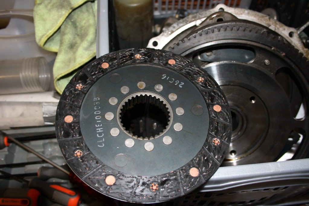

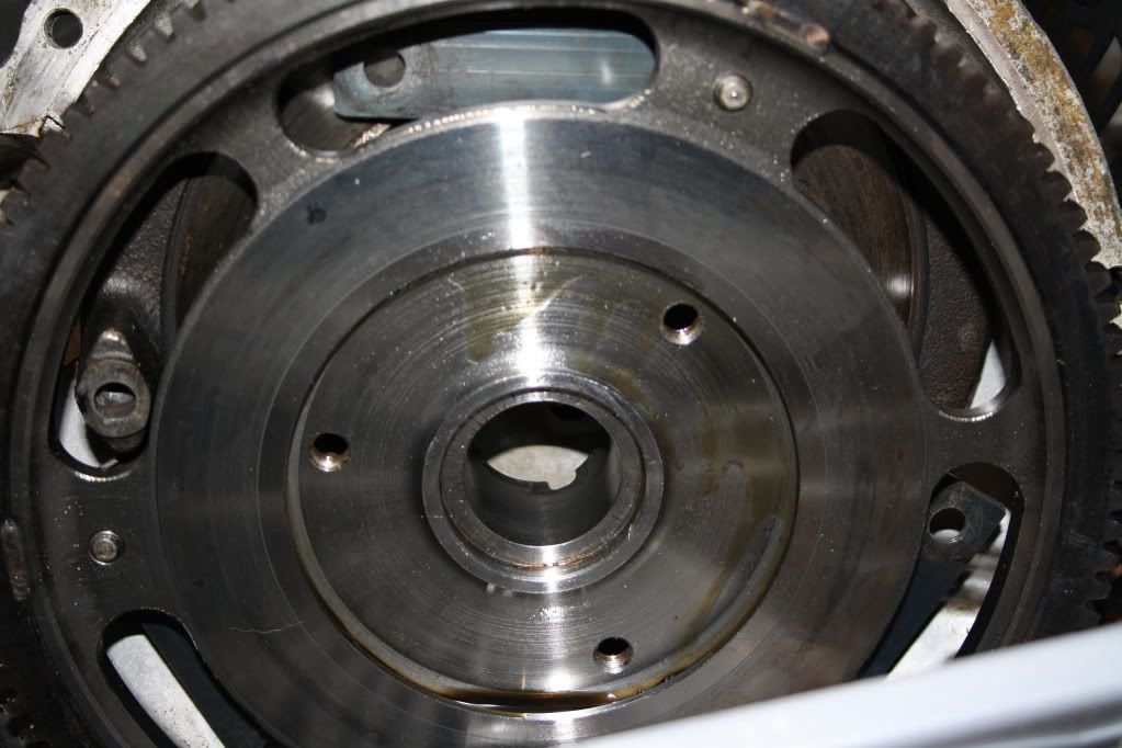

The clutch plate had damp spots.

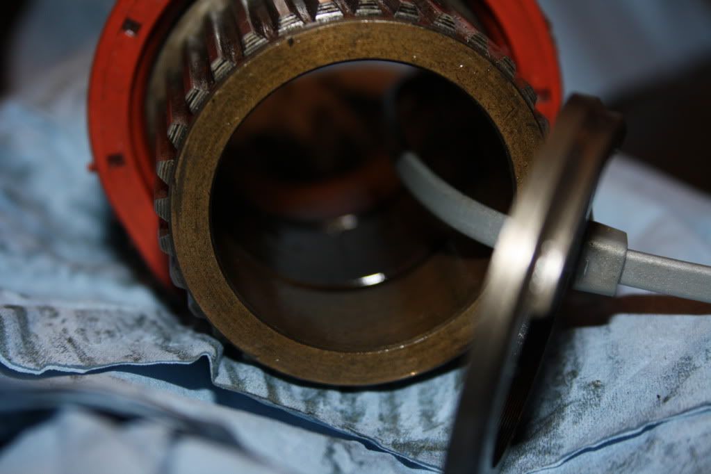

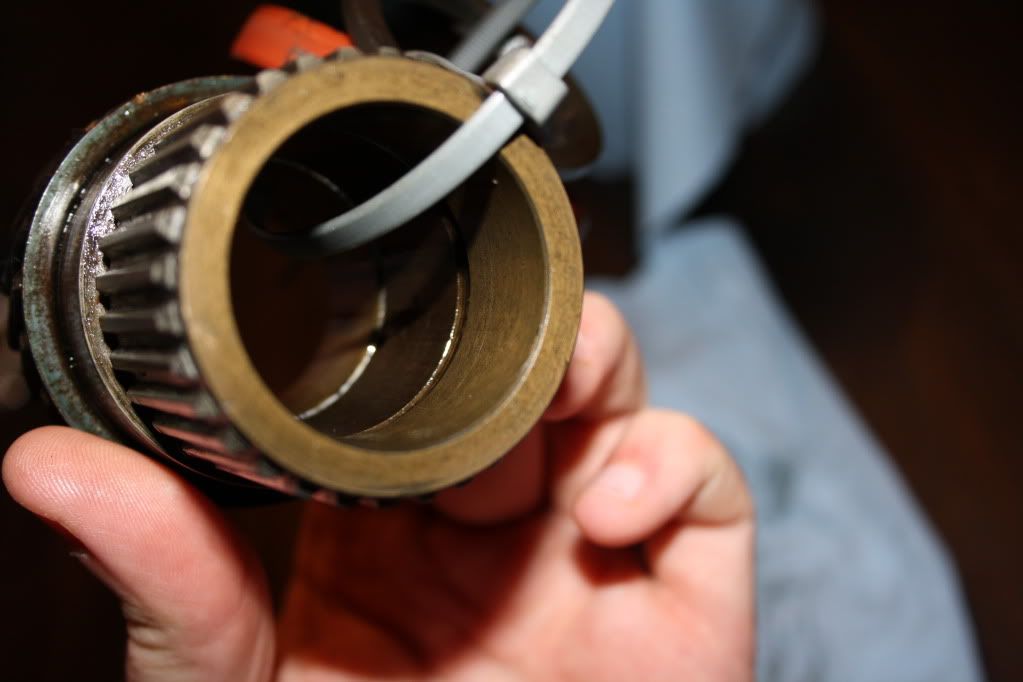

I'm wondering if the primary needs replacing? the pic shows wear marks and it have a healthy amount of oil on the inside. I never felt any side to side movement when it was on the crank with the C washer.
Its a PITA pulling the clutch off in the car....
Thanks for any help.
Graham
What is the bush at the engine side of the primary gear like? That one will allow more movement than the front one (which looks OK to me).

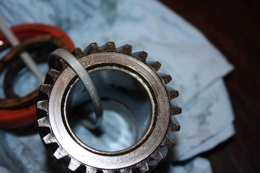

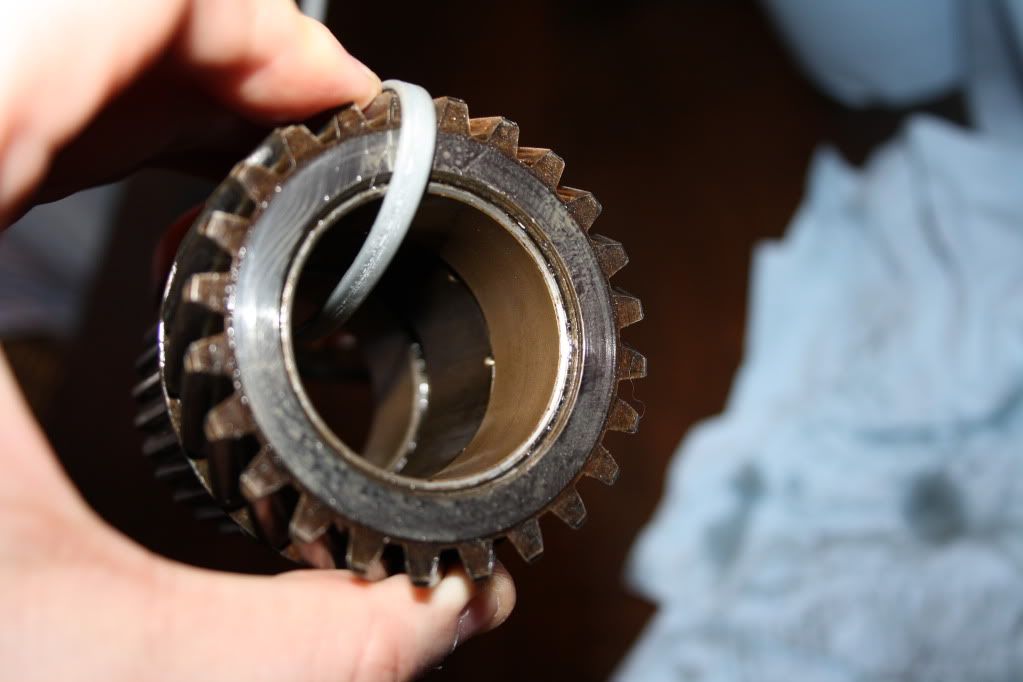

Here is the pic from the other side. I didnt feel and movement on the crank?

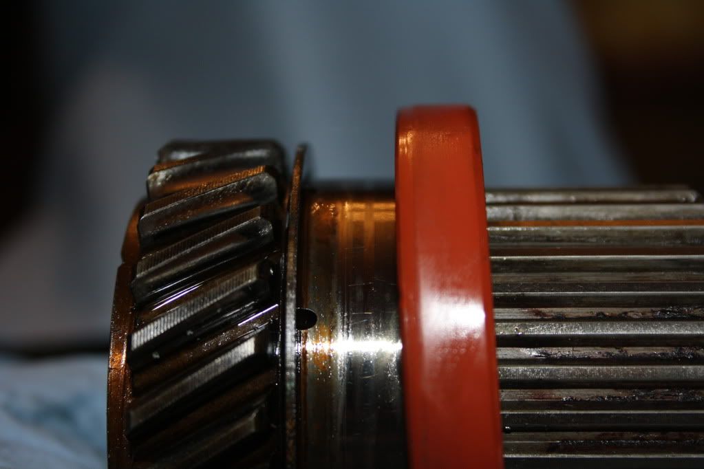

The oil feed holes look very close to the seal wear lines? I cant feel the wear lines with my nail so it cant be much but then maybe it doesnt need much?
Edited by gr4h4m on 8th Jan, 2012.
I meant the bush inside the primary gear *wink*

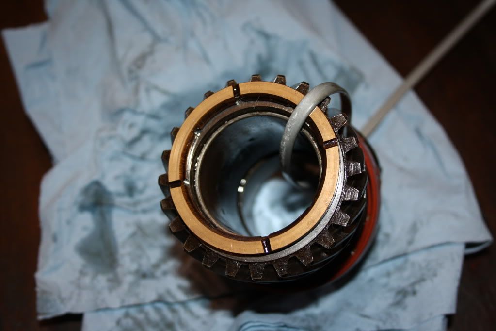

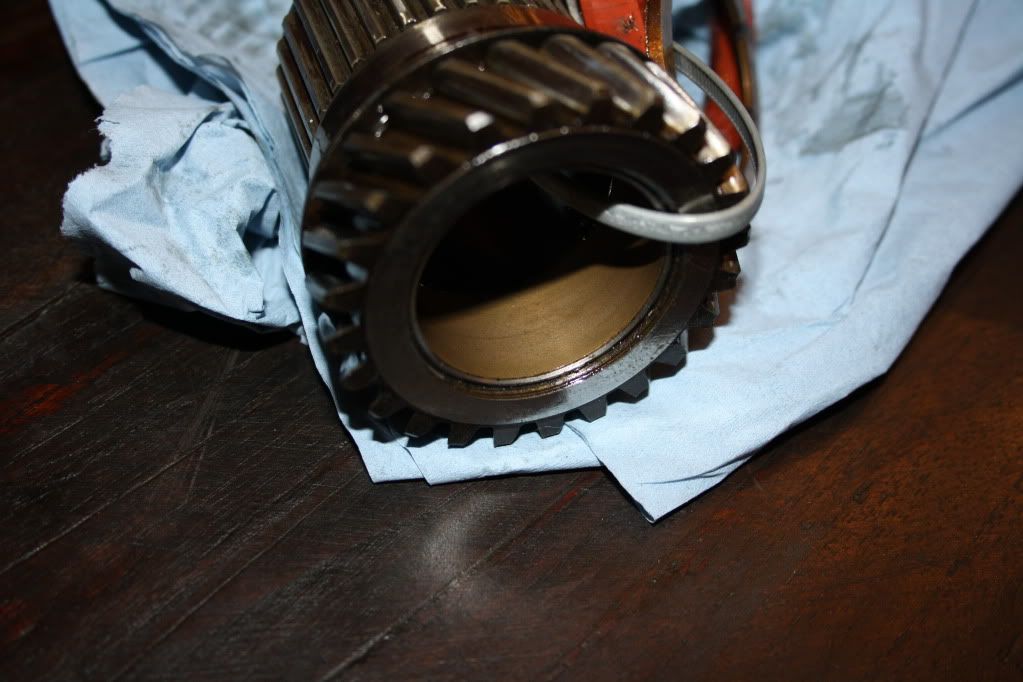

These any good I cant see any scoring they look quite good to me but then I dont know shite about primary gears..
They look OK to me. Is the hole in the transfer case OK?

Is the bush worn, allowing the primary gear to move about?

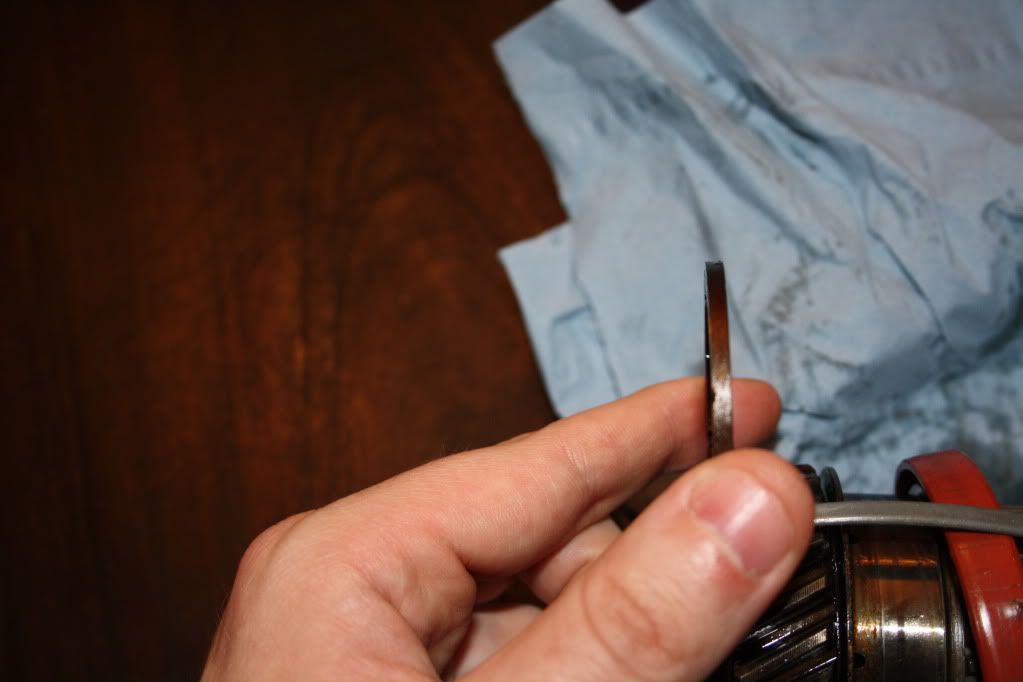

I have been out and measured with a feeler guage between thrust washer and primary.
I get 0.20mm. 0.25mm is very tight but I can force it in if you know what I mean.
Looking at the internet the gap is a little big?
I have read it should between 0.004" to 0.006"
I make mine 0.0078"?
Not sure what I should change
Measure the C clip and it's thrust do dah. We found the one on the van was worn and allowing the primary gear to move about more than is desirable. I should have a couple of 998 ones throwing round I can measure for you if needs be.
the bronze thrust washer measures 0.1155"
The c-clip measures 0.124" and the ring bit measures 0.159"
I need to get another set of feelers as I could only measure with one set which might be getting a false reading.
You can feel a small ridge on the primary where the seal sits so I might order a new one. I cant face taking the clutch off agains its a PITA.
Ok armed with two sets of feelers I measured the float to be 0.004" so that looks within spec.
There is a groove where the seal sits on the gear.
The case looks ok but there are two screw driver marks where someone else had removed the original seal.
I'm starting to think these so called updated red super duper seals are not as duper as the web sites have you believe?

I've measured the new and an old primary and there is no difference with the measuring gear I have. Ideally need a micrometer.
Bush diameter inner is about 38.15 to 38.20 mm both ends. Where seal sits is 54.95 to 55.00 mm.
There is a ring between teeth and where oil seal sits on the new one as shown in your pic, but not on the old one. I'm guessing this was added to stop oil splashing onto the seal from the gears at some point.
