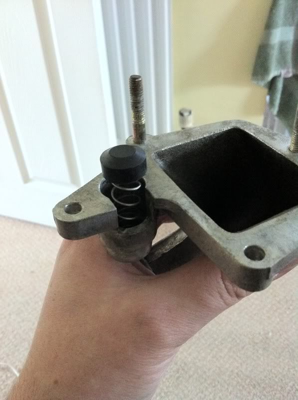

by the restrictor i take it you mean this
didnt take the plenum chamber apart this time and had trouble a couple of months ago when i replaced the plenum chamber gasket, i put it all back together with the restrictor round the wrong way and when i drove it that sounded like the dump valve was permanently open and it didnt feel like the way it drove yesterday
if thats not the restrictor then dont know what bit it is
when i took the turbo out i didnt take apart the plenum or the carb so dont think it could be a bad gasket or blocked hole (can remember the exact bit but its what some people use the T piece method to fix)
No, that's a pressure relief valve tha topens at 10spi to stop over boosting. You'll need to block this if you want more boost.

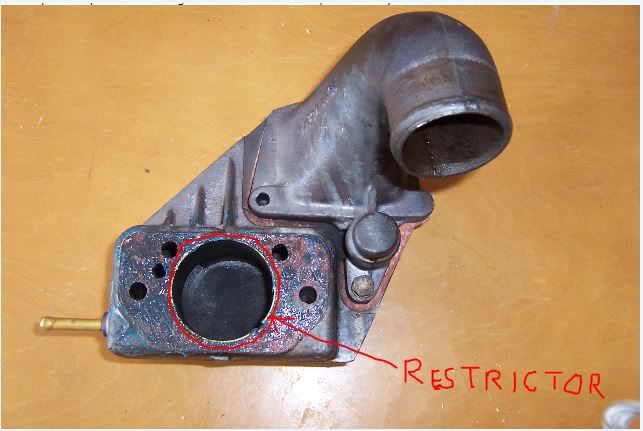

The restrictor is a copper coloured ring at the carb mouth.
You definately need to check that the hole to pressurise the float chamber from the plenum is not blocked by the gasket. The symptoms that you have are exactly what would happen if it was blocked.

I think you may have misread Wil's post. I think he's reffering to the little hole to the left of the plenum chambers hole, on the face that it mounts to the carb. The middle hole on the left in the picture below (not my plenum)
You may have a put a non turbo gasket on and blocked it up accidentally.

You can see the restrictor ring in that plenum. Brass coloured ring inserted in the the large inlet hole.
