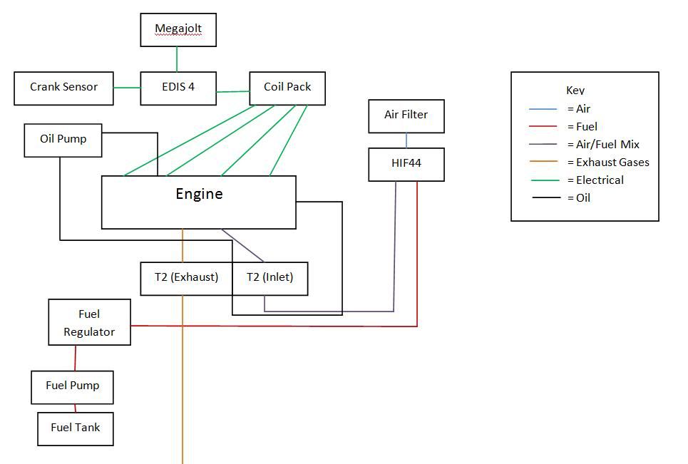

Just put a sketch together to make sure i get all the things i need, and get them all in the right place.
if you can see any problems with this please let me know.
Also, (silly question) whereabouts does the intercooler go in this setup?
Cheers.

Intercooler goes between the turbo and the carb.

On 10th Mar, 2012 Joe C said:
Do not forget
The fuel reg needs a return line to the tank, and also a boost reference signal from the plenum chamber.
air filter is before the turbo. also needs a plenum
Carb is also between turbo and engine.
What you have drawn is a suck through setup.
EFA??
On 26th Jan, 2012 theoneeyedlizard said:
What you have drawn is a fucking rubbish setup.
No sleight on your drawing which is good in principle. But suck through turbo is pretty 70's technology.

Look at these for a start
http://www.turbominis.co.uk/forums/index.php?p=vt&tid=257121
http://www.twin-turbo.co.uk

Well those drawings are a lot more helpful than mine, cheers.
