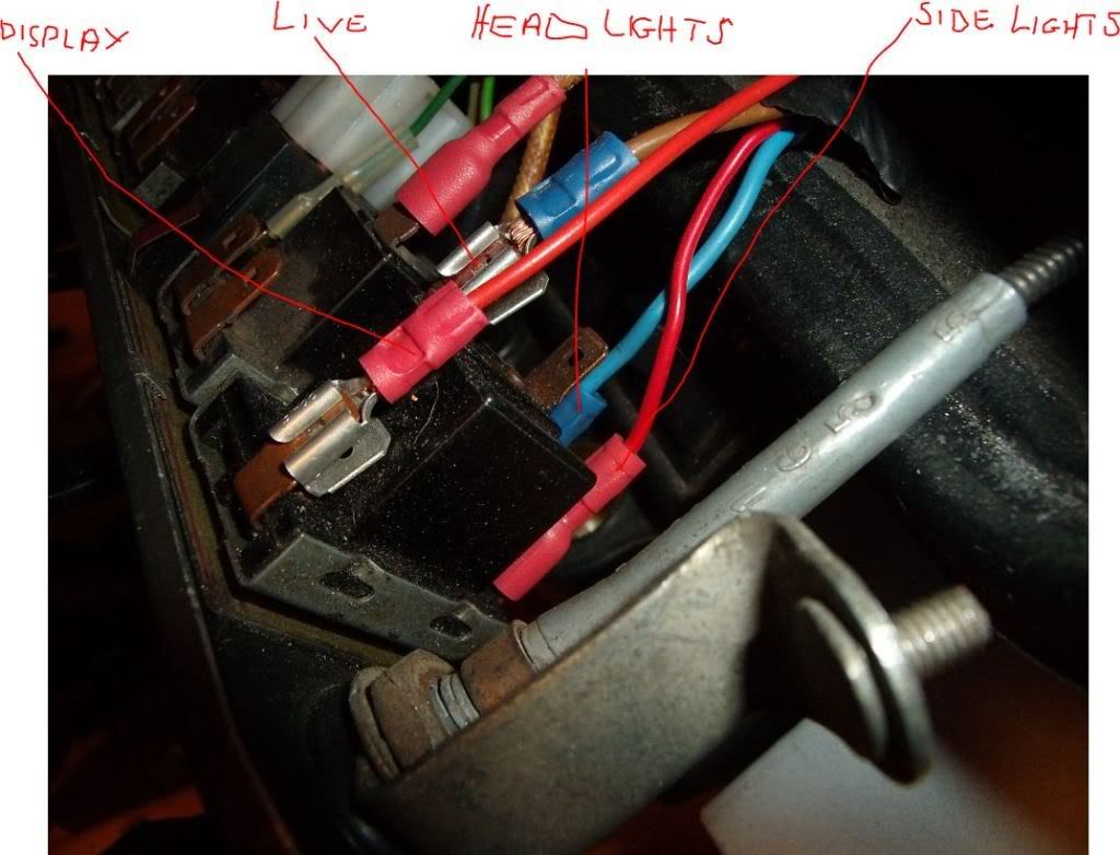

If you have a light switch, that is, OFF, SIDE LIGHTS and HEAD LIGHTS, this may help.. Alan

uninsulated connectors on an unfuzed live? rather you than me :)
Denis O'Brien.
How do you know it's not fused Dennis? *wink*

All my wiring is through a fuse.. Alan
Edited by nala56 on 3rd Feb, 2012.

If you look closer you will see that the terminals are piggy backs in case I want another spur off them, never seen insulated piggy backs, not been able to buy any that are insulated..

Thats the back of the switch in the picture, and the three position one is headlights.. Alan
On 3rd Feb, 2012 RidingLow said:
Ill look on mini spares but I got given the switches you see, has anyone got a picture of the back of a light switch for them?

presuming its the oe loom, and assuming(which is poor form of me i guess) its of a decent vintage it will be unfused, that said fused or not i dont think its safe, neither do i like the uninsulated connector for the indication lamp, which, if the switch is in the on position upon insertion or removal of the panel will short out.
could have worded that original post better, comes across as pretty condensing, apologies :)

It’s a MK3 or MK4 loom that I have fitted and modified, I know what your saying but to be honest if your going to play around with the panel at all, I would take off the battery lead because the terminals by there design don’t push all the way on so you can still short out terminal by accident.. Alan

fair enough i only know cause i got caught out in my first mini and pulled the headlight switch with the sidelights on *tongue* lots of little experiences like that has made me very paranoid about electrics especially when working on older cars like ours where standards were lower.
