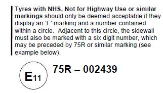

From the MOT test Manual
While it says "Tyres with NHS, Not for Highway Use or similar markings should only be deemed acceptable if they display an ‘E’ marking and a number contained within a circle." Implies that if if the tyre does not show markings NHS or Not For Highway Use it will show the E marking, since why would a tyre be marked not for highway use, but then have an E marking that suggests it is. Contradiction in terms.
Edited by Sprocket on 3rd Feb, 2012.

That quote Sprocket is not for the tyres that he is contemplating. they are for the DOT marked tyres, which these are not.
Considering that they are suitable for hillclimbs aand they take place on what is a highway in most cases, they are unlikey to cause death or injury.
