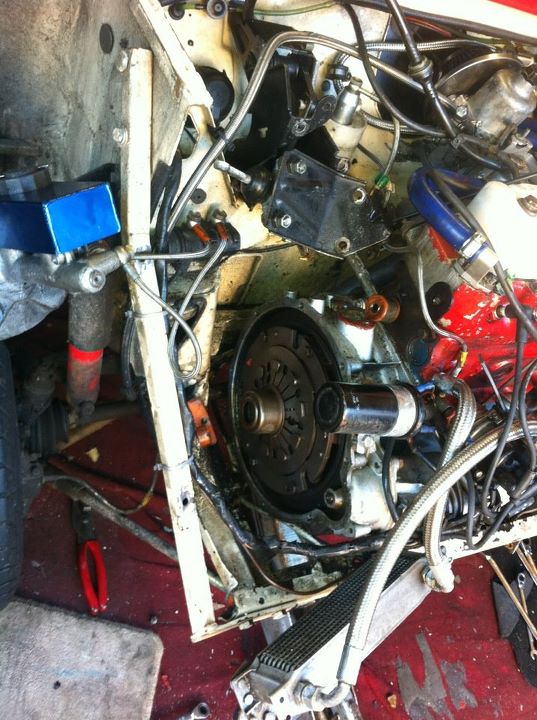

is it possible to change a verto clutch with the brake servo in place on a standard roundnose with all inner wings etc?

Yes, I have done it several times.

Changing a clutch in place is an arse. But an 11mm flexi head ratchet spanner would be an invaluable tool for removing the bellhousing bolts. I wish i had access to one when i changed one last in car. And undo the o/s mount and all steadies and jack the clutch side up as much as you dare.

i know the bolt around the back of the wok is a pig to get out, most people dont put it back in either. i just looked under the bonnet and there just doesnt seem much room at all under the servo, just wanted to make sure i wasnt pissing in the wind before i started. as the new daily ive been to see tonight and am picking up next week has a slipping clutch.

I would check all the hydraulics too mate, happened to me at avon, clutch slippage, thought it was the clutch plate worn, took it all apart and it was fine but glazed over, replaced loads of stuff, put it all together and the clutch was still crap, Ended up changing the master & slave in the end. Worked out that when depressed the clutch was slightly dragging, which glazed the plate over, hence causing slippage. Just something to consider :) I only had the easiest 5 bolts to get to back in, as the bottom section is held in via the weight of the engine pushing against the bellhousing. Not advised on a heavy clutch though.

I don't remember it being that much of a pain. I normally remove all the nuts holding on the servo sto that it can be pushed out of the way, but leave the pipes connected.

changing the clutch is not too bad in situe - changing the primary gear and removing the transfer case on the other hand is a right bitch!!
With mine i have braided hoses going from the servo to the brake bias valve thingymabob, so i usually just unbolt the servo from the servo bracket and move it out the way.
and like others have said, removing the wok bolts can be a pain too. If you jack up the engine this will give you some more room
Plenty of people substitute 1/2 for 13mm as and when. And 11mm is pretty much identical to 7/16. So it fits perfectly. I have never ever had a problem with it. The reason i say 11mm, is because nobody sells flexi ratchet spanners that i know to in AF.
