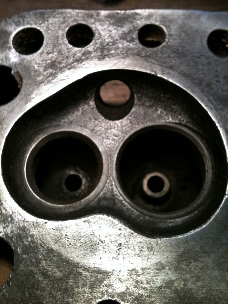

Hi, Just had a search but couldn't find an answer, How can you tell if a cylinder head has been converted to take unleaded fuel? I've bought a 12G295 off ebay and am unsure if it is compatible.
If not, where do you suggest sending it for the conversion?
Thanks
Take a valve out and look for an insert in the seat.
If its not unleaded, don't bother to get it converted.

This should help;
Are the rings around the piston seats where the inserts have been fitted?
Edited by Mike-998 on 9th Feb, 2012.
Those rings are the normal machining marks on the standard leaded head.
I got Turbo Phil to fit unleaded exhaust valve seats in my latest head. I'm running unleaded seats in a standard 12G295 head on my current 998 Turbo.
I would say that head needs a minimal skim to clean it up as well.

Thanks, I'll drop him a PM
