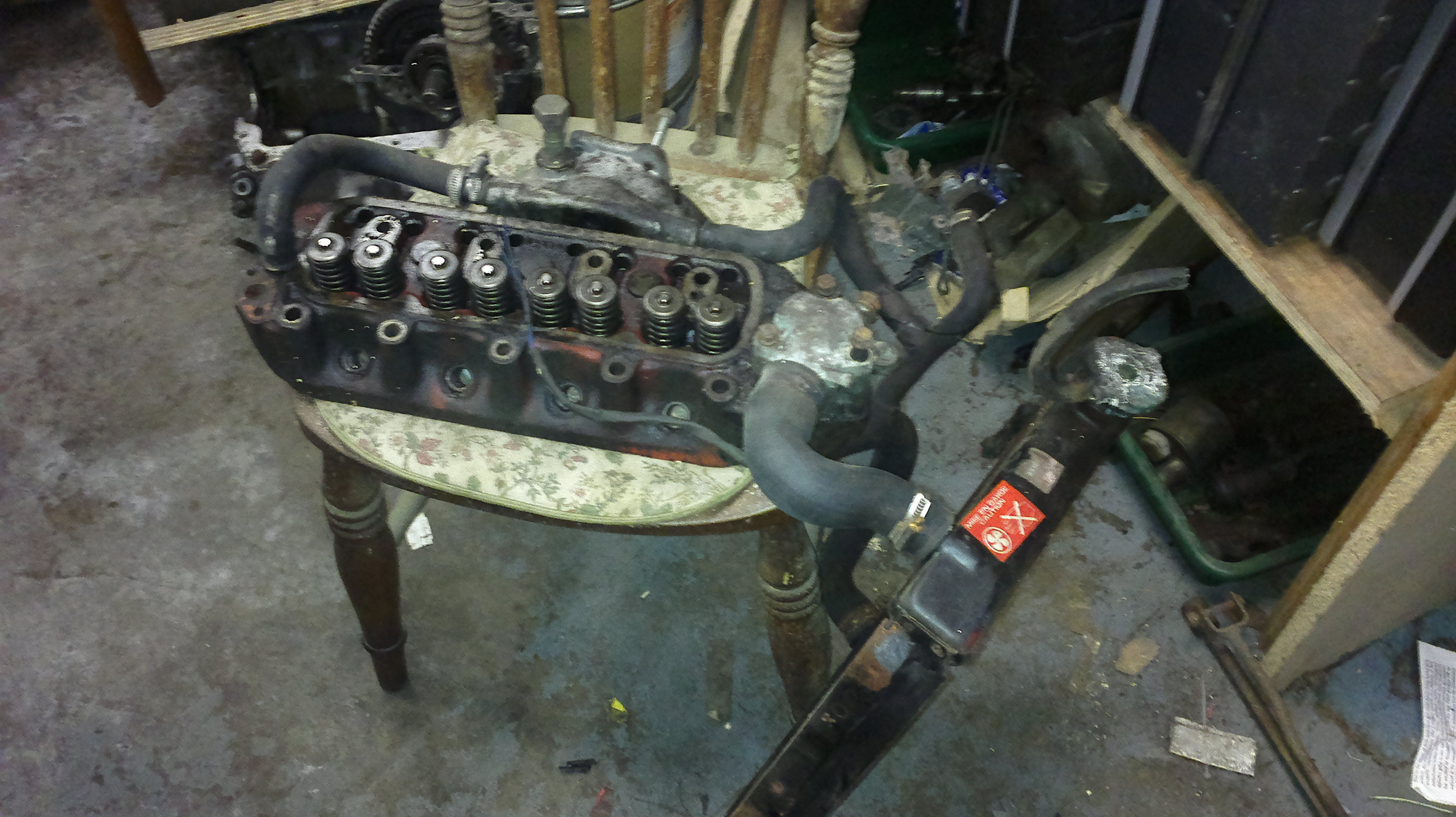

ok, I've been back up to the workshop and had another look at what i have - not quite how I originally saw it.
The bottom hose has the twin pipes but the one i thought went to the sandwich plate looks like it actually goes to the heated manifold.
so as i see it, if i adopt this set up, one of he hoses (the one with the heatervalve) will go through the bulkhead and connect to the heater; the second hose, which used to connect to the no4 outlet via the heated manifold will now connect direct to the no4 takeoff (i'm not using the heated manifold); the connection from the bypass hose will go directly to the heater.
cheers for all your help
rob
Are you feeding the heater from the sandwich plate and returning into the bottom hose?
thats my understanding from this set-up i've got. The takeoff from no4 will feed back into the bottom hose as well
Looking at the picture above, that is a Cooper RSP or Mainstream hose set and configuration.
Why not heating the inlet manifold?
