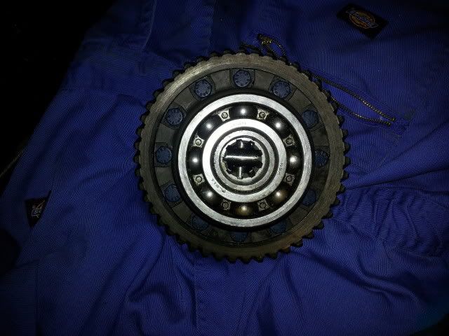

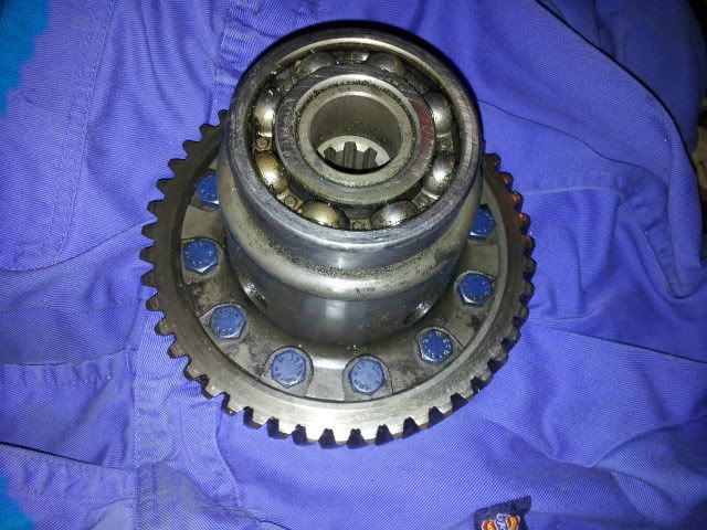

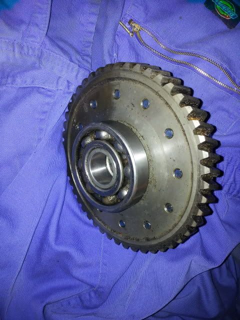

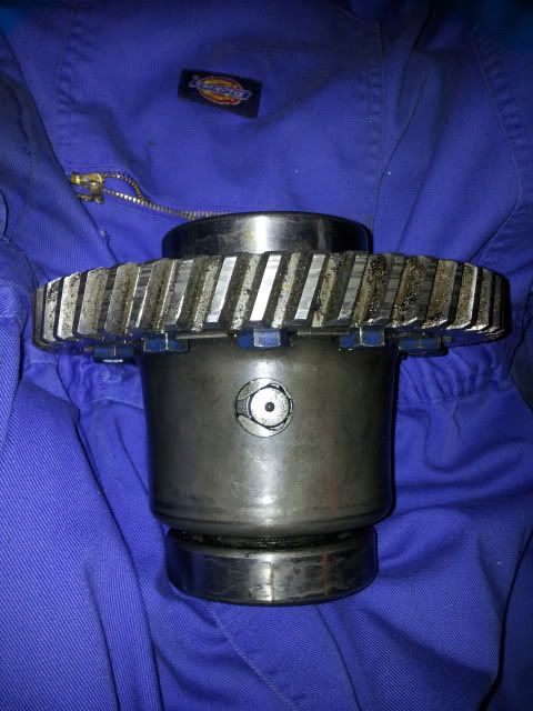

Well here are some shots of the differential. The crown wheel is an integral part of the diff as it acts as one of the pressure plates for the friction pack.

So anyone seen a differential assembly like this before? I would love to keep it but a new crown wheel and pinon will be required.

no idea what it is but http://i726.photobucket.com/albums/ww264/M...87FCF6-orig.jpg
looking at the ramp angles reminds me of a "1.5" or "1 way" plate lsd.
Denis O'Brien.
Cam and pawl? If it is throw the fucker in the bin. There meant to be horrible.
Edited by MikeRace on 20th Feb, 2012.
hmmm,
that all looks a bit funky...
those bearings dont look like the normal mini ones to me, that crown wheel dosent look lie a normal mini one (apart from the extra bolts) it looks like chunkier teeth and straighter cut...

Well its been near two years but I finally have an answer.
Having seen as exploded diagram I now know the differential pictured above is a Gripper differential. That known I should be able to source service parts for it.
Thanks for the feedback lads.
