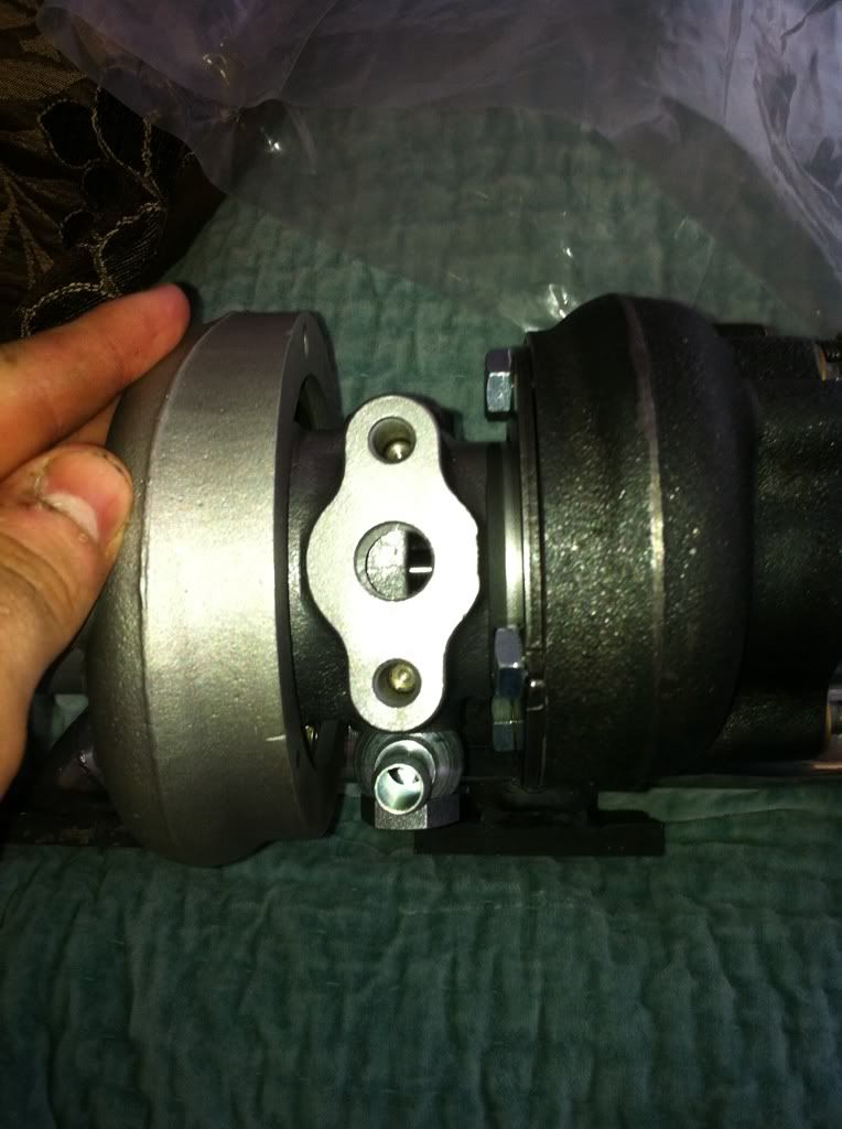

This is my mirage turbo that arrived yesterday
I asked for the full kit just need help I'd the holes
http://www.turbominis.co.uk/forums/index.php?p=vt&tid=445578
The one with the banjo fitting and it's opposite is water. the one on top nearest the flange is the oil feed, the opposite side is the oil return.

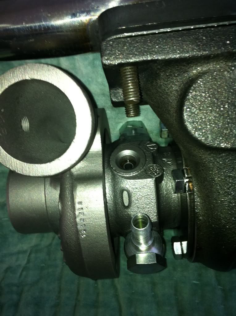

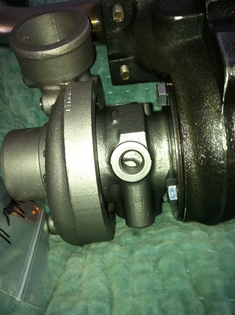

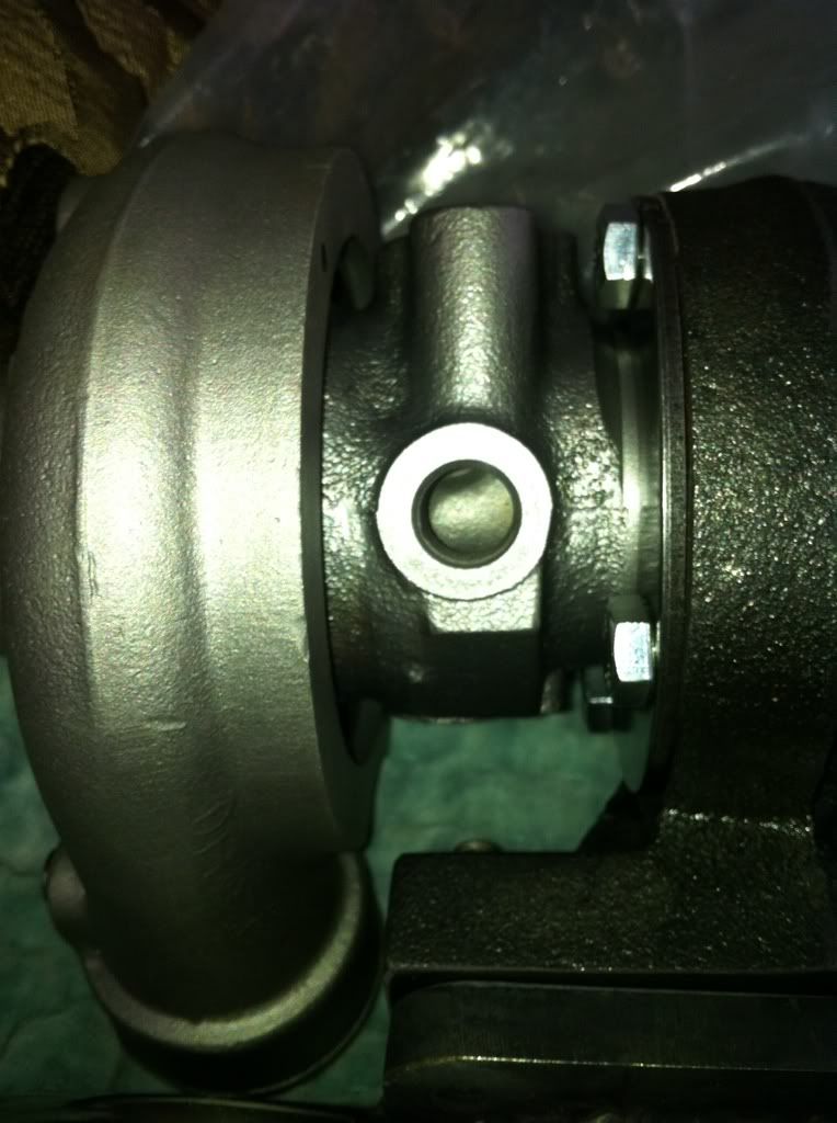

Thx so second pic from top is water feed ?
How would u get an adapter for that one ?
No. The one with the banjo fittings are water.
Second pic from top is oil drain. The remaining one is oil feed.
You'll need to make your own drain.
Mirage used to sell the oil feed for a T2, otherwise you'll need to make one up. Do a search on here it's been covered in detail.
