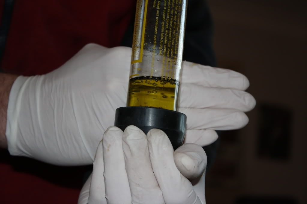

Well firstly a big thanks to colin for lending me his block testing kit...
It went like this

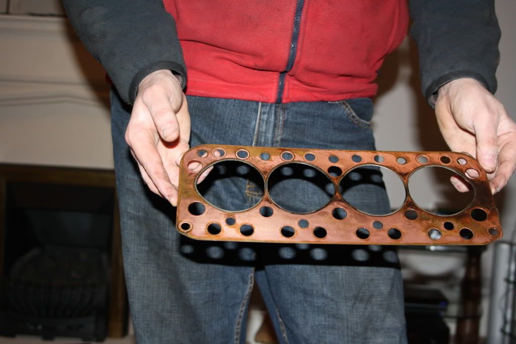

So I pulle the head off which is a PIA on my little engine.
looks like it didnt seal correctly?

what was it torqued to? Iv managed to get this process down to a t now it only take and hour to change one, did mine today
Done now needs redoing lol
all book figures. I'm thinking my torque wrench needs checking??
wng691s clubby
2057 Posts
Member #: 9252
Cleethorpes
may be worth having it checked how long was it running for could just be a dodgy gasket. I just got one of the black fibre ones from mini spares they come with a 3 year warranty and are replaced if blown.
oo just ordered one of them.
Oh poopsicles!
would it be worth having the head skimmed, nothing serious, just enough to be sure it is perfectly flat. A Gnats dick is the technical term here. In an ideal world you'd want to do the block too, but it depends how far you'd want to go with the whole thing I suppose.
I will run a straight edge over the block to see it there is anything however I don't want to pull that too if I can get away with it.
The car did still pull well which is strange.
torque wrence is my opinion after checkeing the above
torque it to 55ft pounds after you have the wrence callibrated or buy a new one
Yep I don't think the correct clamping load was on the head. I have ordered a new stud kit. Maybe I never went to the correct figure.
